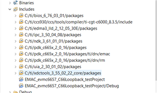

Dear all,there is a TMS320C6657 in our custom board. And I have been stuck with these errors and I can't figure it out.
I can't find where bin file in ccs which can find in my directory
Hi Lee,
My "includes" looks like below,
Could you please include the "C:\ti\pdk_c665x_2_0_16\packages\ti\drv\emac" and "C:\ti\pdk_c665x_2_0_16\packages\ti\drv\rm" folders and compile them.
Also, why "mcsdk" folder is included, have you been trying to use MCSDK projects with "Processor RTOS SDK".
Rajarajan U
Dear Rajarajan
Thank you for your reply
I've tried include "C:\ti\pdk_c665x_2_0_16\packages\ti\drv\emac" and "C:\ti\pdk_c665x_2_0_16\packages\ti\drv\rm" but it doesn't work.
I forgot to say that I tried to debug in release mode.
And I don't know detail about "mcsdk". sorry
