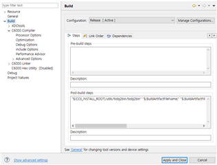

I have .out file which is successfully run in the target. now I need bin file.
I already tried put
"${CCE_INSTALL_ROOT}/utils/tiobj2bin/tiobj2bin" "${BuildArtifactFileName}" "${BuildArtifactFileBaseName}.bin" "${CG_TOOL_ROOT}/bin/armofd" "${CG_TOOL_ROOT}/bin/armhex" "${CCE_INSTALL_ROOT}/utils/tiobj2bin/mkhex4bin"
in Post-build steps, but I can't find bin file in my directory.
Thank you

  • Thank you for your response Shankari
    I'm not using SDK 6.3 and I found more console errors
