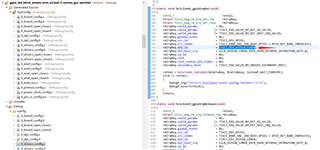

We want to use GPIO input interrupts on the A53 core. So we first used the "gpio_input_interrupt" example to test on the R5 core, which was booted from flash.but this time the example gives the following error on startup:
 [Error] The configuration of the Sciclient event failed !!!
ASSERT: 0.2142s: ../board.c:Sciclient_gpioIrqSet:97: FALSE failed !!!
  • TMDS64GPEVM board.
  • Sdk-linux-am64x-evm-08.04.01.04
  • "gpio_input_interrupt" example

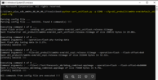

We tried routing GPIO interrupts to A53 core 0 and got the same error.TMDS64GPEVM
 We also tried the following:
  1. We only kept the u-boot.img and tiboot3 .bin compiled with Sdk-linux-am64x-evm-08.04.01.04. Load "gpio_input_interrupt" from ospi flash to R5 core.
  2. Still get errors if we load just the R5F binaries (i.e., no Linux) from ospi flash.
  3. We also tried disable main_gpio0 and main_gpio1 in the k3-am642-evm.dts file.,but it didn't work.

    Step3:Configure interrupt routing for GPIO1_43.
    I did two tests, the first time to route to R5_00 and the second time to route to A53_0.
    GPIO1_43 interrupt  route to R5_00(AMP)
    #define BOARD_BUTTON_GPIO_INTR_NUM      (40U)
    #define TISCI_BANK_SRC_IDX_BASE_GPIO1       (90U)
    #define GPIO_PUSH_BUTTON_PIN (43)
    #define GPIO_PINS_PER_BANK_SHIFT        (4U)
    #define GPIO_GET_BANK_INDEX(pinNum)     (((uint32_t) pinNum) >> GPIO_PINS_PER_BANK_SHIFT)
    #define MAIN_GPIOMUX_INTROUTER0_OUTP_8                                      (40U)
    uint32_t Sciclient_gpioIrqSet(void)
        int32_t                             retVal;
        struct tisci_msg_rm_irq_set_req     rmIrqReq;
        struct tisci_msg_rm_irq_set_resp    rmIrqResp;
        rmIrqReq.valid_params           = 0U;
        rmIrqReq.valid_params          |= TISCI_MSG_VALUE_RM_DST_ID_VALID;
        rmIrqReq.valid_params          |= TISCI_MSG_VALUE_RM_DST_HOST_IRQ_VALID;
        rmIrqReq.global_event           = 0U;
        rmIrqReq.src_id                 = TISCI_DEV_GPIO1;
        rmIrqReq.src_index              = TISCI_BANK_SRC_IDX_BASE_GPIO1 + GPIO_GET_BANK_INDEX(GPIO_PUSH_BUTTON_PIN);
        rmIrqReq.dst_id                 = TISCI_DEV_A53SS0_CORE_0;
        rmIrqReq.dst_host_irq           = MAIN_GPIOMUX_INTROUTER0_OUTP_8;
        rmIrqReq.ia_id                  = 0U;
        rmIrqReq.vint                   = 0U;
        rmIrqReq.vint_status_bit_index  = 0U;
        rmIrqReq.secondary_host         = TISCI_MSG_VALUE_RM_UNUSED_SECONDARY_HOST;
        retVal = Sciclient_rmIrqSet(&rmIrqReq, &rmIrqResp, SystemP_WAIT_FOREVER);
        if(0 != retVal)
            printk("[Error] Sciclient event config failed!!!\n");
        return retVal;
    [sciclient_set_boardcfg, 170]
    [SCICLIENT] ABI check PASSED
    [SCICLIENT] Board Configuration with Debug enabled ...
    [SCICLIENT] Common Board Configuration PASSED
    [SCICLIENT] PM Board Configuration PASSED
    [SCICLIENT] RM Board Configuration PASSED
    [SCICLIENT] Security Board Configuration PASSED
    All tests have passed!!
    [sciclient_set_boardcfg, 279]
    GPIO1_43 interrupt route to A53_0(AMP):Board Configuration at R5_00, but GPIO demo runs on A53_Core0.
    #define BOARD_BUTTON_GPIO_INTR_NUM      (32U)
        int32_t                             retVal;
        rmIrqReq.dst_host_irq           = getGpioButtonIntrNum();
        rmIrqReq.vint                   = 0U;
        if(0 != retVal)
            printf("[Error] Sciclient event config failed!!!\n");
        return retVal;
    [ERROR]Invalid cpu_brandstr AM64x Cortex-A53/1 @ 1.00GHz.
    This A53_Core0
    This A53_Core0

  • Hello,Anil
    OK, thank you very much and look forward to your reply.
    We have used MCU + SDK 8.4 version GPIO interrupt example and testing with jtag(NOBOOT MODE,loading syfw.bin with script). It can work successfully.
    However, if the gpio_ input_ interrupt_ am64x-evm_ r5fss0-0_ nortos_ ti-arm-clang. out file is programmed into OSPI Flash and boot from OSPI flash(setenv serverip 192.168.1.101;setenv ipaddr 192.168.1.100;tftpboot 0x82000000 gpio_ input_ interrupt_ am64x-evm_ r5fss0-0_ nortos_ ti-arm-clang. out;sf probe;sf update 0x82000000 0x280000 0x2c0000), the instance cannot run normally.Maybe you can do the same test to see if the phenomenon is the same as me.
    The customer requested that we only use A53 core0.
    Zhang Ben

  • Hello ,
    I took the example from the MCU+SDK documentation and tested it on my HW. I loaded the GPIO interrupt example into external memory and tested it. It is working well.
    So, you can take the same example from below link.
    C:\ti\mcu_plus_sdk_am64x_08_04_00_17\examples\drivers\gpio\gpio_input_interrupt\am64x-evm
    I suspect a problem with your flashing procedure.
    Generally we have to follow below procedure to load binaries in external memory.
    Pre condition :
    1. Open default_sbl_ospi.cfg file from below path.
    C:\ti\mcu_plus_sdk_am64x_08_04_00_17\tools\boot\sbl_prebuilt\am64x-evm
    2. Give the path of GPIO interrupt example appimage in place marked yellow.
    Procedure :
    1. POWER OFF
    2. Put the board in UART BOOT MODE
    3. Open the following path and open a command prompt window, then you give the below command.
    Command : python uart_uniflash.py -p COM8 --cfg=sbl_prebuilt/am64x-evm/default_sbl_ospi.cfg
    Note : Pease change the com port number based on your USB port number.
    4. Wait for App image transfer via UART and put the board in OSPI BOOT MODE
    5. POWER ON
    Please let me know if you face any problem .
    S.Anil.
  • Hello Anil,
    I tested it on my TMDS64GPEVM board, it is working well.Could you please yell me ,what files constitute appimage? In other words, what are the differences between appimage and .out files.
    My customer has customized a board with AM64x chip and used the boot of linux sdk0802. In the future, it will switch to linux sdk0804 and boot our own RTOS through uboot.
    We porting the GPIO, sciclient and other drivers of the sdk to our RTOS bsp, but we were unable to configure GPIO interrupt.Except for the GPIO interrupt, other drivers work well.So,how to configure GPIO interrupt routing in our own RTOS through sciclient.
    Sorry, my expression and my English may not be very good.
    Zhang Ben

  • Hello Anil,
    I found a bug in .syscfg.This is auto-generated code, and the dst_id is wrong.
    Zhang Ben.
  • Hello ,
    We have also found this issue and will raise a Jira ticket to fix this issue in future releases.
    Thanks for the update .
