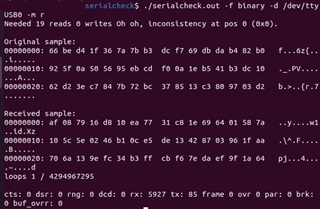

The result would always be
timeout, RX/TX: 459/0
Needed 5 reads 0 writes Oh oh, inconsistency at pos 0 (0x0).
I checked the content that is received and it seems to be a snippet of the original sample instead of the whole sample.
