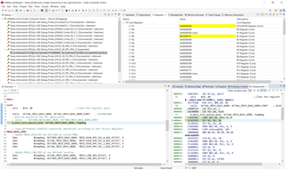

The PRU cores add great value to TI's processor lineups. However the debugging experience in CCS leaves something to be desired. For example, debugging PRU assembly in CCS becomes difficult when macros are used since each debugger step shifts the focus back to the file that called the macro, not the file where the macro is located. This also results in line highlighting being unhelpful since the highlight position is on the line that called the macro instead of the line that's actually being executed within the macro. TI's examples make heavy use of macros so this problem comes up often when debugging.
Are there any options in CCS that might provide a better experience when debugging macros in PRU assembly?

    When debugging PRU assembly there are 2 step buttons, "Assembly Step Into" and "Assembly Step Over". If I use the "Assembly Step Into" button the line that called the macro remains highlighted until the last macro instruction is executed. It does not shift focus to the source file where the macro is located or step through the assembly inside the macro.
    The disassembly window does show all instructions as they are executed, but it only shows the "raw" assembly without comments or context.

    To be clear, the program counter does continue pointing to the assembly instruction being executed in the disassembly window. But the line highlighting does not track in the source code window.
    Here's an example using CCS v12.1 on Windows with AM64EVM (new one, SR2.0) with XDS200 JTAG. I am using the PRU MDIO example provided in MCU+ SDK v8.04 (located at <sdk>/examples/pru_io/mdio_fw).
    After program loaded, I stepped until I reached the first macro on line 77:
    Pressing "Assembly Step Into" once:
    Note the source code window on the bottom left continues to highlight the same line in main.asm that called the macro even though it's now executing the macro "m_mdio_init_manual_mode" (defined in the include file mdio_macros.inc, not in main.asm).
    I can reproduce the same behavior. When looking at the modules view, I don't see any reference of the symbol is question. I'm following up with one of the debugger engineers and will pass on any updates as I get them.

    The debug information says that m_mdio_init_manual_mode maps to line 77 in main.asm. There is nothing in the debug symbols that maps to the mdio_macros.inc file. Hence the debugger is behaving as expected based on the generated debug symbols for the executable.
    The question is if the emitted debug symbols are correct or not. I will need to follow up with the compiler team on this one.

    Preliminary investigation seem to indicated that this is a known limitation. In any case, I have filed a bug of this issue.
    Tracking link: https://sir.ext.ti.com/jira/browse/EXT_EP-10943
