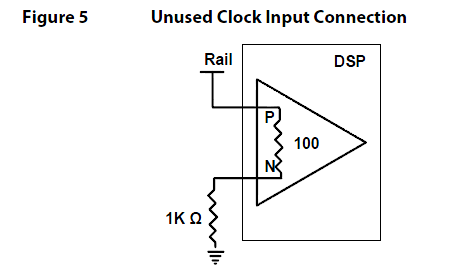

About the unused clock pin of C6678
Hi
SPRABI2 Page 15 has the recommended connections of the unused clock input pins for Keystone devices:
I want to know here which power rail is? Is it 1.0V? Since   says " You shouldn't start them before the 1V AVS is present because the clock buffers are powered by 1V." in http://e2e.ti.com/support/dsp/c6000_multi-core_dsps/f/639/p/116580/413748.aspx#413748
Thanks in advance!
