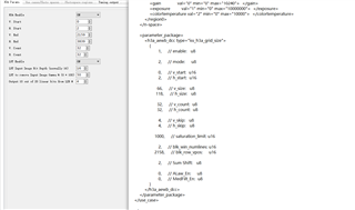

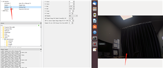

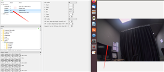

 Dear TI engi neers, Recently, we e ncountered a problem. When we were debugging and testing the stability of AE outdoors, we found that our current AE would jump back and forth with a certain increase, which was shown in DCC as Again at 4.5-4.6 times gain, with a change of only 0.1 times gain and a strong change in the brightness of the screen. The fusion area of WDR seems to increase disharmony and the pulsation amplitude is too large. How can we solve this problem? Attached are our current H3A parameters and relevant scene pictures that are reproduced. Please inform us in time if you need any other information
