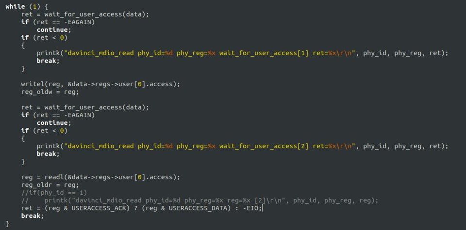

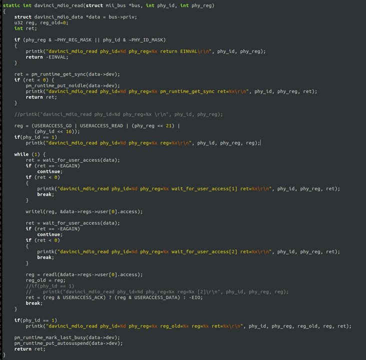

Hi .
Customer is using the 7.x SDK version of the AM57.
The fail log cause the kernel stuck, meanwhile, the Phy is off.
They are using :
            2 DP83867 for CPSW.
            2 DP82822 for PRU.
You can check the attached log or the below.
The RTI will cause the Phy + kernel stuck.
please provide the solution, thanks.
BR Rio

    Update some information.
    I tried to get more log about this issue, and found it might cause in davinci read function. It seems do some access via control ICSSG_USER_ACCESS_REG.
    Below are my logs:
    [ 243.169139] davinci_mdio_read phy_id=1 phy_reg=1 reg_old=2021796d reg=2021796d ret=796d
    [ 244.192681] phy_read addr=1 regnum=0
    [ 244.192691] davinci_mdio_read phy_id=1 phy_reg=0 reg=80010000
    [ 244.192912] davinci_mdio_read phy_id=1 phy_reg=0 reg_old=20011140 reg=20011140 ret=1140
    [ 244.192918] phy_read addr=1 regnum=1
    [ 244.192921] davinci_mdio_read phy_id=1 phy_reg=1 reg=80210000
    [ 244.193141] davinci_mdio_read phy_id=1 phy_reg=1 reg_old=2021796d reg=2021796d ret=796d

    The read message comes from here, and it seems doing some access with icssg?
    I'm not sure about this. But the reg is not correct finally, and got the wrong return value.
    Anyone can explain about this?
    Eric
    I add more log about this.
    The reg_oldw is saved after call into writel(reg, &data->regs->user[0].access);
    And reg_oldr is aved after call into readl(&data->regs->user[0].access);
    Not sure why the reg is changed to an unuassaully value.

    #3. Please see this SDK8.4 work-around of the "AM64" in the below posted picture.
          Then, how is the work-around patch for AM65? Since AM65 is only having the SDK8.2.
          Please comment.
    BR Rio
  • we are investigating how to provide patches that are 5.10 kernel (same as what is AM65x PSDK 8.2) for you to test.
    Are we sure the issue seems related to the MDIO issue?
  • Hi ,
    Is there any further info about this?
    Eric
  • Hi Eric,
    Apologies for delayed response.
    Here are the attached patches with MDIO configured in manual mode.
    /cfs-file/__key/communityserver-discussions-components-files/791/linux_5F00_mdio_5F00_cdc_5F00_patch_5F00_v3.tar.gz
    Rimika
  • Hi ,
    Got it. I need few days to test it and feedback to you later.
    Thanks.
    Eric
  • Hi  and
    I have tested it on Ti EVM with SDK 8.2.
    I just wonder if you expect the log "flow control off" disappear totally.
