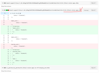

  • After I enable DSS on A72 for using Qt GUI application, I newly built k3-j721s2-vision-apps.dtbo.
    Below is k3-j721s2-vision_apps.dts fixed.
  • Thanks for sharing this fix, we will fix this in the upcoming SDK release.
  • Hi Brijesh, I am working with Unkyoung. It seems there was a misunderstanding in communication between you and Unkyoung.
    Unkyoung told "Below is k3-j721s2-vision_apps.dts fixed.", but it was NOT FIXED(he said wrong). We just changed k3-j721s2-vision_apps.dts to enable DSS on A72 because we should use qt display with vision_apps. So this issue is not resolved yet. Please keep checking this issue.

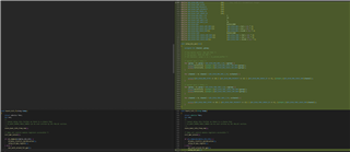

  • Also, I checked one more thing.
    I compared The PSDK Linux 8.4.0.11 for J721E and 8.4.0.13 J721S2's j721e_init.c.
    The difference is define CONFIG_TI_SECURE_DEVICE.
    The 8.4.0.11 (j721e) includes code about define CONFIG_TI_SECURE_DEVICE, but 8.4.0.13 (j721s2) doesn't.
    This code (define CONFIG_TI_SECURE_DEVICE) includes setup_dss_qos.
    Could I need to try to add code about define CONFIG_TI_SECURE_DEVICE into 8.4.0.13 (j721s2)'s j721s2_init.c ?
  • Hi Lee,
    Please copy this part of the code from J721E release into j721s2_init.c file and call this API just before spl_early_init API call.
    Brijesh
