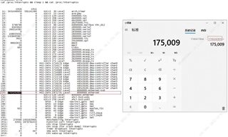

During test found some board running slowly. There is no abnormal in system log, further investigate found there are many unexpected Ethernet interrupt as below two snapshot of cat /proc/interrupts. the Ethernet cable is not connected during booting. .

    Could you please provide more detail on how the system if running slowly? Are you saying that when the ethernet cable is not connected you are getting a lot of interrupts?

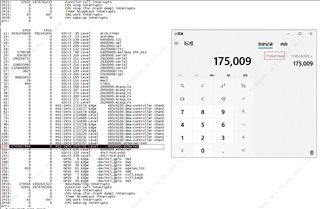

    What is the number that is being subtracted from to get to the 175009 number. What do the two screens captures represent with the math?
    Is the log captures from the good board when the cable is plugged in?
    Schuyler
  • Could you please provide more detail on how the system if running slowly?
    even can't launch application when so frequency interrupt triggered.
    Yes.
    captured log every 500ms, calculate how many times interrupt happened every 1 second.
    when issue not happened, without ethernet cable connected.

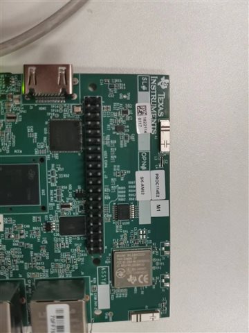

  • Hi Patton:
    Could you please take a picture about your EVM board. We can double confirm with our side AM62-SK EVM board hardware version.
    You are using AM62 linux version is 08.05.00.21?
    Tony has try verify it at RDK8.03 and latest 8.05 all easy reproduce it. When he come back office will contact you about reproduce method. Believe at our hands EVM two version RDK all can find the same problem.

    root@am62xx-evm:~# cat /proc/interrupts | grep  8000000.ethernet
    124:          0          0          0          0  MSI-INTA 1970707 Level     8000000.ethernet-tx0
    214:          0          0          0          0  MSI-INTA 1971731 Level     8000000.ethernet
    247:          0          0          0          0     GICv3 134 Level     8000000.ethernet
    root@am62xx-evm:~# ifconfig eth0 down
    root@am62xx-evm:~# ifconfig eth1 down
    root@am62xx-evm:~# ifconfig eth0 up
    [   58.873942] TI DP83867 8000f00.mdio:00: attached PHY driver [TI DP83867] (mii_bus:phy_addr=8000f00.mdio:00, irq=POLL)
    [   58.894072] am65-cpsw-nuss 8000000.ethernet eth0: Link is Down
    124:          1          0          0          0  MSI-INTA 1970707 Level     8000000.ethernet-tx0
    214:    1071912          0          0          0  MSI-INTA 1971731 Level     8000000.ethernet
    root@am62xx-evm:~#
