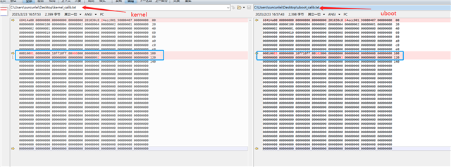

        2. Here are the register dump in u-boot stage and kernel stage. Since they have some difficulty in reproducing the case so we only have dump in good condition. We will update the bad condition's once we reproduce it.

        3. As you can see from the comparison below, even in good condition they have different dump in u-boot and kernel stage. Will this be a cause?

        3. Is it normal to have such differences?
    BR

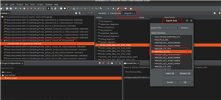

  • Hi Sikai
    You can dump the register like this so that it is easy to read
    Diwakar
