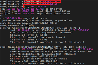

We run the SDK 8.2.2 in j784s4 EVM board ,and we connect it to PC.
After installing the prebuilt package on the board and logging in to linux, set the IP of ETH0 to 192.168.3.78 and set the IP of the PC to  192.168.3.100.
And we can ping PC ok on linux.

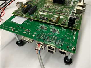

But we run the SDK 8.2.2 in j784s4 EVM board ,and we connect it to GESI board.Then connect the Ethernet port of GESI to the PC.

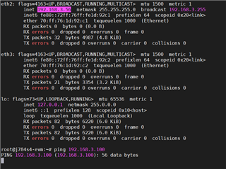

After installing the prebuilt package on the board and logging in to linux, set the IP of ETH2 to 192.168.3.56 and set the IP of the PC to  192.168.3.100.
But we cannot ping PC ok on linux.
