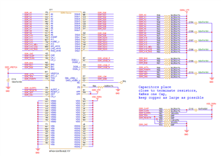

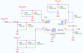

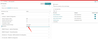

On custom board,stopped after tiboot3,and normal on PROC114E2 EVM board.please help to analyze any possible causes.
On custom board,log is as followed:
U-Boot SPL 2021.01-g1028347851 (Dec 05 2022 - 09:34:09 +0000)
SYSFW ABI: 3.1 (firmware rev 0x0008 '8.4.7--v08.04.07 (Jolly Jellyfi')
esm main init 1202
esm main init 1202 q
esm main init 1202 qa
esm main init 1202 qaa
esm main init 1202 qxx
board_init_r 1
board_init_r 1-1
board_init_r 2
board_init_r 3
board_init_r 4
board_init_r 5
board_init_r 6
spl_board_init 1
spl_board_init 2
spl_board_init 3
spl_board_init 4
dram_init_banksize 1
fdtdec_setup_memory_banksize 1
spl_board_init 10
board_init_r 6-1
board_init_r 8
board_init_r 9
board_init_r 11
board_init_r 12
spl_boot_device 1
board_init_r 13
boot_from_devices esm main init 1205
Trying to boot from MMC2
/* no more output */

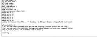

On PROC114E2 EVM board,log is as followed:
U-Boot SPL 2021.01-g35e4b8eb56 (Dec 05 2022 - 11:15:00 +0000)
esm main init 1202
board_init_r 1
board_init_r 1-1
board_init_r 2
board_init_r 3
board_init_r 4
board_init_r 5
board_init_r 6
spl_board_init 1
spl_board_init 2
spl_board_init 3
spl_board_init 4
spl_board_init 10
board_init_r 6-1
board_init_r 8
board_init_r 9
board_init_r 11
board_init_r 12
spl_boot_device 1
board_init_r 13
spl_mmc_boot_mode 1
board_init_r 15
board_init_r 16
board_init_r 20
board_init_r 23
board_init_r 31
board_init_r 33
board_init_r 36
Loading Environment from MMC... *** Warning - No MMC card found, using default environment
spl_boot_device 1
Starting ATF on ARM64 core...
NOTICE: BL31: v2.7(release):v2.7.0-dirty
NOTICE: BL31: Built : 06:06:15, Nov 18 2022
U-Boot SPL 2021.01-g35e4b8eb56 (Dec 05 2022 - 11:14:58 +0000)
esm main init 1202
spl_boot_device 1
board_init_r 1
board_init_r 1-1
board_init_r 2
board_init_r 3
board_init_r 4
board_init_r 5
board_init_r 6
spl_board_init 1
spl_board_init 2
spl_board_init 3
spl_board_init 4
spl_board_init 10
board_init_r 6-1
board_init_r 8
board_init_r 9
board_init_r 11
board_init_r 12
spl_boot_device 1
board_init_r 13
spl_mmc_boot_mode 1
board_init_r 15
bank 0
bank 0
bank 1
bank 2
board_init_r 16
board_init_r 20
board_init_r 23
board_init_r 33
board_init_r 36
