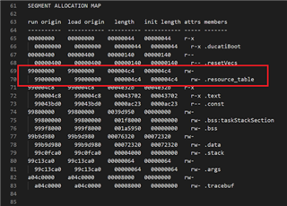

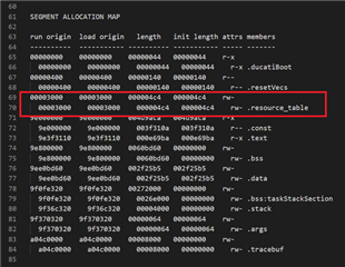

Suspicions:
1. Caused by memory conflict
Map data of IPU: resource_ Address and L2 of table_ ROM coincidence. Suspected abnormal
The normal address of IPU2 or DSP1/DSP2: resource_ Table address and IPU2_ CODE_ MEM address is consistent
2. Loading file caused an exception
It is found that the *. rsc file is deleted and the same error is reported in the log. Open the *. rsc file and find the resource_ The table is inside. It is suspected that the initialization problem is caused by the abnormal loading of the rsc file.
