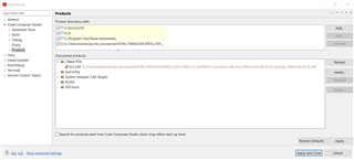

I am currently trying to create a new wizard project on CCS v12.1.0 for the J784S4 EVM. I have done the CCS patch from the ti-processor-sdk-j784s4-evm-08_02_02_02 as it is explained in the CCS setup of the SDK RTOS.
In the Preferences of CCS, I added the product discovery path of the ti-processor-sdk-j784s4-evm-08_02_02_02. It added the J784S4 PDK 8.2.2.04. I attached the picture of the products window.

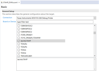

I am able to create the target config file for the J784S4 (know as J7AHP), to debug it and to run the demo application binary on the device. I attached the picture of the target config file.
But I can't create a wizard project for this device (it isn't in the target list).
