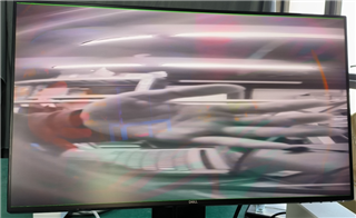

I am using sdk 07.3 to bring up a 5M UYVY camera (2592 x 1808). But I meet a problem for displaying on screen.
The image on screen through DP output is shown in figure 1, in which the Y and UV channel are mismatched, and the frame is not fully displayed.
In this situation,  I press 's' to save YUV image, the saved image is UYVY format and can be normally displayed using YUV PLAYER (see figure 2).
Could you help me to allocate the cause of this problem?
figure 1 image on screen                                                                  figure 2 saved UYVY image
