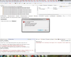

Board-2
Error connecting to the target:
(Error -241 @ 0x0)
A router subpath could not be accessed.
A security error has probably occurred.
Make sure your device is unlocked.
(Emulation package 8.4.0.00006)
js:> loadJSFile C:\Users\Admin\workspace_v8\am57xx-dss-files\am57xx-ctt.dss
Error connecting to the target: emulation failure occurred (C:\Users\Admin\workspace_v8\am57xx-dss-files\am57xx-ctt.dss#231)

    Board-2:
    It's not connecting to internal cores also and all voltages generating and reset also coming to the device
    Could you give me some suggestions
