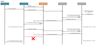

The second DMA completion interrupt does not occur under the following conditions.
 * PDMA initialization parameters : elemCnt=4, fifoCnt=1
 * UART receive data size : 16byte
It seems DMA has finished correctly, as the data is written to the destination address of the memory. ( see Sequence No.15 and 16)
Does anyone have an idea what the possible causes are?
Interrupt is set to Enable.
(2)
A DMA completion interrupt does not occur under the following conditions. (see Sequence No.9 )
 * PDMA initialization parameters : elemCnt=64, fifoCnt=64

  • Hi ,
    (1)
    Can you please try setting elemCnt and fifoCnt in the DMA registers? I see in the driver, that it is set everytime, transfer API is called. So can you please try setting it again?
    Is there any constraint on elemCnt and fifoCnt?
    Please set elemCnt and fifoCnt everytime you want to received data. Please refer to API UART_receiveDMA for these parameter's calculation..

  • Hi ,
    PDMA parameters should be set with the expected input size and should also match with the uart configuration. It shouldn't be set with the maximum possible expected size..
    Brijesh
  • Hi Brijesh,
    Sorry for the late reply.
    Thanks to your advice, the issue with receiving processing has been resolved.
