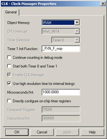

I have the clock manager properties set so that th microseconds/int is 1000.  This means that the low resolution clock or system tick is at 1ms?   If that is so doing a TSK_Sleep(1) should yield a 1ms sleep time?  when I do this I see that the task sleep for about 300usec.  I have a task that send message out and puting a scope on the hardware line shows that I have a 300usec delay.  Why am I not getting the 1ms

    The clock manager will 'tick' every 1ms in that scenario. The TSK_sleep will return after it sees a single 'tick.' Even though the timer generates an interrupt every 1ms, the TSK_sleep will be called anywhere between 0-1ms. This means that the next tick could be less than 1ms away. Try upping to the TSK_sleep argument 2 and see if the time ends up somewhere between 1-2ms.

    My seconds/interrupt rate (CLK Manager properties) is 1000us, so I understand one tick takes one milisecond. However, when doing a TSK_sleep(100) I have experimentally checked that it spends just 1.5ms when it should take 100ms. Why this behaviour?
    Any suggestion would be appreciated.
    best regards
  • Make sure that you have specified the correct frequency in the Global Settings Properties. The clock module feeds down from the speed you specify inside the Global Settings - it cannot "figure out" the actual frequency at run-time.
    Also, what testing method are you using to determine that this actually takes just 1.5ms?

  • At run time take a look at the timer's period register - does it look right for a 1ms interval? If you change the TSK_Sleep calls to 200 does it sleep for 3 seconds?

    I have checked the elapsed time for a TSK_Sleep(100) and it is of 1.22 seconds (not the 1.5 seconds I told before, I measured it wrong). And yes, for a double tick amount it sleeps the double of time (2.44 seconds).
    However, I don´t know how to check the prd register at run time. Whats is the register address if the programs loads at 0x10000000 IRAM? The only information I have found is in C672X CSL reference guide (sprc223, page 21)  regarding 0x01940000 and 0x01944000 addresses so I check them with View->Memory in CCS, but I am not completely sure if this is the procedure.

  • The easiest way is to check the Clock Manager Properties inside your BIOS Configuration File to see how the Timer is configured. See the attached photo.

    I have just checked the Clock Manager Properties at run time and it displays the same values shown in your attached photo. I still do not know what happens.
  • I created an example project on my PADK eval board and I do see the 100ms output, so I am confident this is running properly. Please see the attached project and scope shot.

    However the problem persists with your code (1.22 sec output).
    The only change I made was to use my own .tcf for my custom board. Anyways I have compared both tcf and I do not see any difference.
