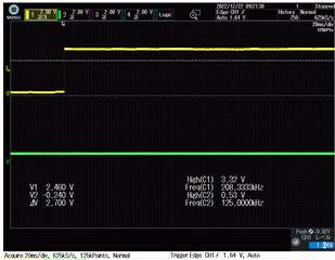

My customer powers up the Sitara with the following settings, but the SPI CS0 is not asserted.
SYSBOOT[18 : 0] --> 010_0100_0000_0100_0010
They confirmed the SYSBOOT setting by connecting JTAG after powering up.
With this setting, the AM437x outputs CLKOUT1, so the boot ROM seems to be working.
SPI FLASH is connected to AM437x SPI port.
Any idea why the SPI CS0 is not asserted?
Since it may be a hardware problem, please tell me what to check with the hardware.
