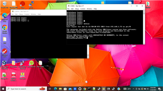

  • Hi Mark,
    Sorry for my late response.
    Not sure if you have solved the issue, but I made the similar change on my BBB and U-Boot still boots with the new model name.
    U-Boot SPL 2021.01-00006-gebe8c8e00d39-dirty (Jan 11 2023 - 14:43:55 -0600)
    Trying to boot from MMC1
    U-Boot 2021.01-00006-gebe8c8e00d39-dirty (Jan 11 2023 - 14:43:55 -0600)
    CPU  : AM335X-GP rev 2.1
    Model: TI AM335x BBB Test
    DRAM:  512 MiB
    WDT:   Started with servicing (60s timeout)
    NAND:  0 MiB
    MMC:   OMAP SD/MMC: 0, OMAP SD/MMC: 1
    Loading Environment from FAT... *** Warning - bad CRC, using default environment
    <ethaddr> not set. Validating first E-fuse MAC
    Net:   eth2: ethernet@4a100000, eth3: usb_ether
    Hit any key to stop autoboot:  0
    Here is uboot change I made:
    diff --git a/arch/arm/dts/am335x-boneblack.dts b/arch/arm/dts/am335x-boneblack.dts

    I create Debian 10 buster SD card as I need python I finally get this to boot BUT 30 seconds later(no uboot no kernel messages just login
    Here is login prompt
  • beaglebone login: debian
