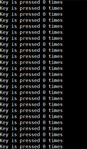

  • Hi Vaibhav,
    1. After I modified the device tree according to this post, it was found that the problem of interrupt abnormality disappeared. After I short-circuited GPIO0_15 and GND, I could indeed detect the input interrupt.
    2. For the same device tree, I modified the example.syscfg file in ccs, changed GPIO0_15(E5) to GPIO0_16(D4), and copied the executable files, am62-mcu-m4f0_0-fw and gpio_input_interrupt_am62x-sk_m4fss0-0_nortos_ti-arm-clang.out, to the development board via FTP. At this time, after the power-on, am62-mcu-m4f0_0-fw would be loaded. The interrupt configuration error would not be prompted, but at this time GPIO0_16 (P9 terminal 11 bit) and GND were short-circuited. At this time, the application program cannot detect the binary input and remained in the state of waiting for the binary input interrupt.
    3. I used the method of loading the out file. I first switched to the /sys/class/remoteproc/remoteproc0 directory, and then checked that the M core status was 'running'. I entered echo stop > state to stop the M core program, loaded the out file (echo m4fss_firmware/ *.out > firmware), and then entered echo start > state to run. The result was different at this time, and the interrupt configuration abnormality was reported again, which was consistent with the initial issue.
    4. I used the grep command to search the device tree files of kernel and boot and found no definition of GPIO0_15 and GPIO0_16 nodes. Now I don’t know how to solve the problem that GPIO0_16 cannot use the input interrupt.

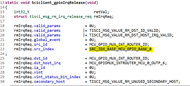

  • Hello Katherine,
    Please confirm which GPIO pin you want to use for your application.
    I understand you want to go with MCU_GPIO016.
    So, in that case update to SRC_IDX_BASE_MCU_GPIO_BANK_1 in marked yellow line in your application.
