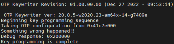

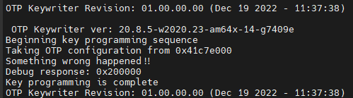

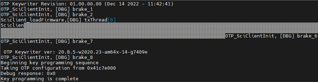

I'm doing key programming. I succeeded keywriting with Ti dummy key.
I used keys (k3_dev_mpk.pem, k3_dev_mek.txt, ti_fek_public.pem from Ti korea, ti-fs-keywriter-j721e.bin from Ti korea) for Ti dummy key.
I tried to generate a custom keys so I used command "gen_keywr_cert.sh -g".
That creates some files(aes256.key, smek.key, smpk.pem) and I copied ti_fek_public.pem to keys/tifekpub.pem.
Finally, I get keywrite app but it has error.
Could you tell me reason?
