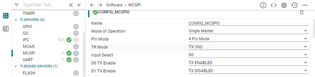

1. Customer wanted to realize IPC function.  He used the mcspi_performance_8bit demo in mcu_plus_sdk_am62x_08_04_00_16 and replaced the new built am62-mcu-m4f0_0-fw file in /lib/firmware/, the test result is that the received data are not the same to transmitted data. It prompted below message.
2. He tested another mcspi_loopback demo, it works. After modifying it to external loopback, it still works.

    1. Customer tested the mcspi performance 8 bit demo.
    2. He tested the MCU pins and didn't modify the example.syscfg file. He tested the mcspi_loopback, both the internal loopback and external loopback(modify the example.syscfg ) work correctly which means the hardware is OK.

    I have recreated your issue. I am also getting the same output as yours and I see it says, "Data Mismatch at offset 1".
    I am working on it, and I will come up with a fix to it. (Please allow me sometime for the same, as I will debug and try to find the problem at the granular level)
