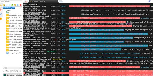

Hello, Takuma
I have added the GST_DEBUG=4 on the command and the result picture is as follow:
Hi Zhang,
Apologies for the delay, I was traveling for work. Could you share the full logs from GST_DEBUG=4 as a text file?
Takuma
