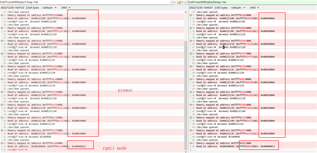

Hello Champs,
Customer wanted to migrate PHY to ti-processor-sdk-rtos-j721e-evm-08_04_00_02, the PHY is linked, but it can't get the IP address. If set to static IP, it still can't ping.
BTW, the PHY has been ported to SDK 7.3 successfully. The pinmux,rgmii mode are all correct.
rgmii pinmux
root@j7-evm:~# devmem2 0x00011C100
/dev/mem opened.
Memory mapped at address 0xffff99f50000.
Read at address 0x0011C100 (0xffff99f5c100): 0x00050004
root@j7-evm:~# devmem2 0x00011C104
/dev/mem opened.
Memory mapped at address 0xffff92e40000.
Read at address 0x0011C104 (0xffff92e4c104): 0x00050004
root@j7-evm:~# devmem2 0x00011C108
/dev/mem opened.
Memory mapped at address 0xffff991d0000.
Read at address 0x0011C108 (0xffff991dc108): 0x00050004
/dev/mem opened.
Memory mapped at address 0xffff94620000.
Read at address 0x0011C108 (0xffff9462c108): 0x00050004
/dev/mem opened.
Memory mapped at address 0xffff9f200000.
Read at address 0x0011C108 (0xffff9f20c108): 0x00050004
root@j7-evm:~# devmem2 0x00011C110
/dev/mem opened.
Memory mapped at address 0xffff97ef0000.
Read at address 0x0011C110 (0xffff97efc110): 0x00050004
root@j7-evm:~# devmem2 0x00011C12C
/dev/mem opened.
Memory mapped at address 0xffffb3f40000.
Read at address 0x0011C12C (0xffffb3f4c12c): 0x00010004
root@j7-evm:~# devmem2 0x00011C130
/dev/mem opened.
Memory mapped at address 0xffff7edf0000.
Read at address 0x0011C130 (0xffff7edfc130): 0x00010004
root@j7-evm:~# devmem2 0x00011C134
/dev/mem opened.
Memory mapped at address 0xffffa89e0000.
Read at address 0x0011C134 (0xffffa89ec134): 0x00010004
root@j7-evm:~# devmem2 0x00011C138
/dev/mem opened.
Memory mapped at address 0xffff9b070000.
Read at address 0x0011C138 (0xffff9b07c138): 0x00010004
root@j7-evm:~# devmem2 0x00011C140
/dev/mem opened.
Memory mapped at address 0xffff88a30000.
Read at address 0x0011C140 (0xffff88a3c140): 0x00050004
root@j7-evm:~# devmem2 0x00011C13C
/dev/mem opened.
Memory mapped at address 0xffffb25d0000.
Read at address 0x0011C13C (0xffffb25dc13c): 0x00050004
root@j7-evm:~#
rgmii mode
root@j7-evm:~# devmem2 0x104050
/dev/mem opened.
Memory mapped at address 0xffffa1c10000.
Read at address 0x00104050 (0xffffa1c14050): 0x00000012
root@j7-evm:~#

    Can you check if there is any difference in the following registers between SDK 7.3 and SDK 8.4
    • 0x0C000F08
    • 0x0C000F0C

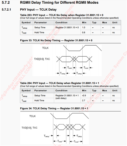

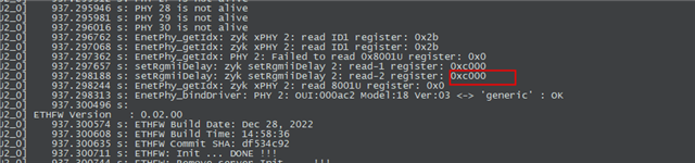

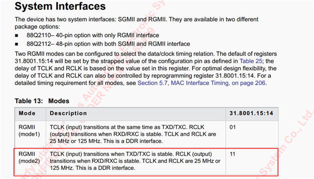

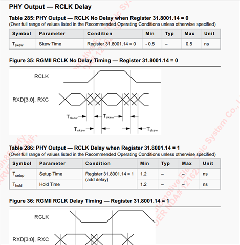

    Also can you provide what are the internal delays configured in the phy?

    You can turn the tx and rx delays on and off in the phy using bootstraps in the hardware design. This is the usual practice. Please let me know what are they configured as. There will also be some phy register which has this information.
    Please provide response on this.

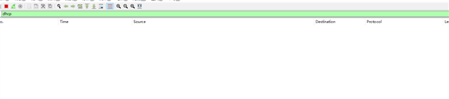

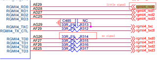

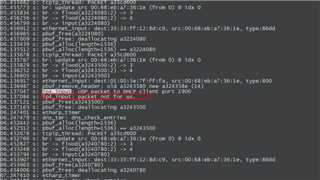

    rgmii default mode2
    Can't get the IP
    Configure to Mode1, but still can't get the IP

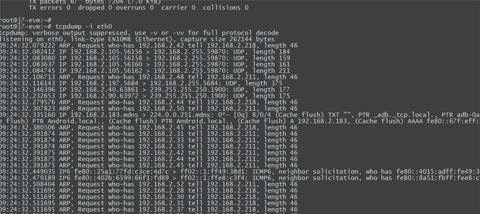

    root@j7-evm:~# ifconfig
    eth1: flags=4163<UP,BROADCAST,RUNNING,MULTICAST> mtu 1500 metric 1
    inet6 fe80::72ff:76ff:fe1d:92c1 prefixlen 64 scopeid 0x20<link>
    ether 70:ff:76:1d:92:c1 txqueuelen 1000 (Ethernet)
    RX packets 88 bytes 8120 (7.9 KiB)
    RX errors 0 dropped 0 overruns 0 frame 0
    TX packets 23 bytes 3714 (3.6 KiB)
    TX errors 0 dropped 0 overruns 0 carrier 0 collisions 0
    eth2: flags=4163<UP,BROADCAST,RUNNING,MULTICAST> mtu 1500 metric 1
    inet6 fe80::72ff:76ff:fe1d:92c2 prefixlen 64 scopeid 0x20<link>
    ether 70:ff:76:1d:92:c2 txqueuelen 1000 (Ethernet)
    RX packets 0 bytes 0 (0.0 B)
    lo: flags=73<UP,LOOPBACK,RUNNING> mtu 65536 metric 1
    inet 127.0.0.1 netmask 255.0.0.0
    inet6 ::1 prefixlen 128 scopeid 0x10<host>
    loop txqueuelen 1000 (Local Loopback)
    RX packets 82 bytes 6220 (6.0 KiB)
    TX packets 82 bytes 6220 (6.0 KiB)
    The 100M is fine, there is eth0. But when using PHY, there is no eth0.
    Below is the whole log.

  • Hi Tanmay,
    Below is the customer's reply.
    Customer enable the print on 8.4 dhcp, he created a dhcp server on Win10.
    --- a/pdk_jacinto_08_04_00_21/packages/ti/transport/lwip/lwip-stack/src/include/lwip/debug.h
    +++ b/pdk_jacinto_08_04_00_21/packages/ti/transport/lwip/lwip-stack/src/include/lwip/debug.h
    @@ -143,14 +143,8 @@
    #ifdef LWIP_DEBUG
    #define LWIP_DEBUGF(debug, message) do { \
    - if ( \
    - ((debug) & LWIP_DBG_ON) && \
    - ((debug) & LWIP_DBG_TYPES_ON) && \
    - ((s16_t)((debug) & LWIP_DBG_MASK_LEVEL) >= LWIP_DBG_MIN_LEVEL)) { \
    + if (1) { \
    LWIP_PLATFORM_DIAG(message); \
    - if ((debug) & LWIP_DBG_HALT) { \
    - while(1); \
    } while(0)
    7.3 can send out dhcp cmd
    8.4 print as below,wireshark no dhcp cmd(filtering)

    [MCU2_0] 1080.501812 s: etharp_timer
    [MCU2_0] 1080.501890 s: dns_tmr: dns_check_entries
    [MCU2_0] 1081.501818 s: etharp_timer
    [MCU2_0] 1081.501896 s: dns_tmr: dns_check_entries
    [MCU2_0] 1082.494848 s: pbuf_alloc(length=1536)
    [MCU2_0] 1082.494923 s: pbuf_alloc(length=1536) == a325ae00
    [MCU2_0] 1082.495088 s: tcpip_thread: PACKET a35ced00
    [MCU2_0] 1082.495180 s: br: update src 00:68:eb:a7:36:1e (from 0) @ idx 0
    [MCU2_0] 1082.495240 s: br -> flood(a325a780:2) -> 3
    [MCU2_0] 1082.495307 s: br -> flood(a325a780:2) -> 4
    [MCU2_0] 1082.495360 s: br -> input(a325a780)
    [MCU2_0] 1082.495453 s: ethernet_input: dest:33:33:ff:12:8d:c9, src:00:68:eb:a7:36:1e, type:86dd
    [MCU2_0] 1082.495505 s: pbuf_free(a325a780)
    [MCU2_0] 1082.495545 s: pbuf_free: deallocating a325a780
    [MCU2_0] 1082.501813 s: etharp_timer
    [MCU2_0] 1082.501887 s: dns_tmr: dns_check_entries
    [MCU2_0] 1083.466847 s: pbuf_alloc(length=1536)
    [MCU2_0] 1083.466918 s: pbuf_alloc(length=1536) == a325a780
    [MCU2_0] 1083.467085 s: tcpip_thread: PACKET a35ced00
    [MCU2_0] 1083.467177 s: br: update src 00:68:eb:a7:36:1e (from 0) @ idx 0
    [MCU2_0] 1083.467240 s: br -> flood(a325a100:2) -> 3
    [MCU2_0] 1083.467306 s: br -> flood(a325a100:2) -> 4
    [MCU2_0] 1083.467355 s: br -> input(a325a100)
    [MCU2_0] 1083.467451 s: ethernet_input: dest:33:33:ff:12:8d:c9, src:00:68:eb:a7:36:1e, type:86dd
    [MCU2_0] 1083.467505 s: pbuf_free(a325a100)
    [MCU2_0] 1083.467544 s: pbuf_free: deallocating a325a100
    [MCU2_0] 1083.501818 s: etharp_timer
    [MCU2_0] 1083.501897 s: dns_tmr: dns_check_entries
    [MCU2_0] 1084.466852 s: pbuf_alloc(length=1536)
    [MCU2_0] 1084.466927 s: pbuf_alloc(length=1536) == a325a100
    [MCU2_0] 1084.467095 s: tcpip_thread: PACKET a35ced00
    [MCU2_0] 1084.467188 s: br: update src 00:68:eb:a7:36:1e (from 0) @ idx 0
    [MCU2_0] 1084.467249 s: br -> flood(a3259a80:2) -> 3
    [MCU2_0] 1084.467315 s: br -> flood(a3259a80:2) -> 4
    [MCU2_0] 1084.467365 s: br -> input(a3259a80)
    [MCU2_0] 1084.467459 s: ethernet_input: dest:33:33:ff:12:8d:c9, src:00:68:eb:a7:36:1e, type:86dd
    [MCU2_0] 1084.467514 s: pbuf_free(a3259a80)
    [MCU2_0] 1084.467555 s: pbuf_free: deallocating a3259a80
    [MCU2_0] 1084.501816 s: etharp_timer
    [MCU2_0] 1084.501894 s: dns_tmr: dns_check_entries
    [MCU2_0] 1085.497867 s: pbuf_alloc(length=1536)
    [MCU2_0] 1085.497940 s: pbuf_alloc(length=1536) == a3259a80
    [MCU2_0] 1085.498165 s: tcpip_thread: PACKET a35ced00
    [MCU2_0] 1085.498255 s: br: update src 00:68:eb:a7:36:1e (from 0) @ idx 0
    [MCU2_0] 1085.498320 s: br -> flood(a3259400:2) -> 3
    [MCU2_0] 1085.498386 s: br -> flood(a3259400:2) -> 4
    [MCU2_0] 1085.498437 s: br -> input(a3259400)
    [MCU2_0] 1085.498532 s: ethernet_input: dest:33:33:ff:12:8d:c9, src:00:68:eb:a7:36:1e, type:86dd
    [MCU2_0] 1085.498586 s: pbuf_free(a3259400)
    [MCU2_0] 1085.498627 s: pbuf_free: deallocating a3259400
    [MCU2_0] 1085.501813 s: etharp_timer
    [MCU2_0] 1085.501878 s: dns_tmr: dns_check_entries
    [MCU2_0] 1086.465850 s: pbuf_alloc(length=1536)
    [MCU2_0] 1086.465924 s: pbuf_alloc(length=1536) == a3259400
    [MCU2_0] 1086.466092 s: tcpip_thread: PACKET a35ced00
    [MCU2_0] 1086.466183 s: br: update src 00:68:eb:a7:36:1e (from 0) @ idx 0
    [MCU2_0] 1086.466244 s: br -> flood(a3258d80:2) -> 3
    [MCU2_0] 1086.466312 s: br -> flood(a3258d80:2) -> 4
    [MCU2_0] 1086.466362 s: br -> input(a3258d80)
    [MCU2_0] 1086.466454 s: ethernet_input: dest:33:33:ff:12:8d:c9, src:00:68:eb:a7:36:1e, type:86dd
    [MCU2_0] 1086.466506 s: pbuf_free(a3258d80)
    [MCU2_0] 1086.466546 s: pbuf_free: deallocating a3258d80
    [MCU2_0] 1086.501819 s: etharp_timer
    [MCU2_0] 1086.501890 s: dns_tmr: dns_check_entries
    [MCU2_0] 1087.463854 s: pbuf_alloc(length=1536)
    [MCU2_0] 1087.463931 s: pbuf_alloc(length=1536) == a3258d80
    [MCU2_0] 1087.464099 s: tcpip_thread: PACKET a35ced00
    [MCU2_0] 1087.464189 s: br: update src 00:68:eb:a7:36:1e (from 0) @ idx 0
    [MCU2_0] 1087.464251 s: br -> flood(a3258700:2) -> 3
    [MCU2_0] 1087.464317 s: br -> flood(a3258700:2) -> 4
    [MCU2_0] 1087.464368 s: br -> input(a3258700)
    [MCU2_0] 1087.464463 s: ethernet_input: dest:33:33:ff:12:8d:c9, src:00:68:eb:a7:36:1e, type:86dd
    [MCU2_0] 1087.464515 s: pbuf_free(a3258700)
    [MCU2_0] 1087.464557 s: pbuf_free: deallocating a3258700
    [MCU2_0] 1087.501818 s: etharp_timer
    [MCU2_0] 1087.501893 s: dns_tmr: dns_check_entries
    [MCU2_0] 1088.501813 s: etharp_timer
    [MCU2_0] 1088.501893 s: dns_tmr: dns_check_entries
    [MCU2_0] 1089.501809 s: etharp_timer
    [MCU2_0] 1089.501885 s: dns_tmr: dns_check_entries
    [MCU2_0] 1089.510843 s: pbuf_alloc(length=1536)
    [MCU2_0] 1089.510913 s: pbuf_alloc(length=1536) == a3258700
    [MCU2_0] 1089.511077 s: tcpip_thread: PACKET a35ced00
    [MCU2_0] 1089.511169 s: br: update src 00:68:eb:a7:36:1e (from 0) @ idx 0
    [MCU2_0] 1089.511231 s: br -> flood(a3258080:2) -> 3
    [MCU2_0] 1089.511297 s: br -> flood(a3258080:2) -> 4
    [MCU2_0] 1089.511347 s: br -> input(a3258080)
    [MCU2_0] 1089.511440 s: ethernet_input: dest:33:33:ff:12:8d:c9, src:00:68:eb:a7:36:1e, type:86dd
    [MCU2_0] 1089.511491 s: pbuf_free(a3258080)
    [MCU2_0] 1089.511532 s: pbuf_free: deallocating a3258080
    [MCU2_0] 1090.466848 s: pbuf_alloc(length=1536)
    [MCU2_0] 1090.466919 s: pbuf_alloc(length=1536) == a3258080
    [MCU2_0] 1090.467080 s: tcpip_thread: PACKET a35ced00
    [MCU2_0] 1090.467174 s: br: update src 00:68:eb:a7:36:1e (from 0) @ idx 0
    [MCU2_0] 1090.467237 s: br -> flood(a3257a00:2) -> 3
    [MCU2_0] 1090.467302 s: br -> flood(a3257a00:2) -> 4
    [MCU2_0] 1090.467355 s: br -> input(a3257a00)
    [MCU2_0] 1090.467450 s: ethernet_input: dest:33:33:ff:12:8d:c9, src:00:68:eb:a7:36:1e, type:86dd
    [MCU2_0] 1090.467503 s: pbuf_free(a3257a00)
    [MCU2_0] 1090.467544 s: pbuf_free: deallocating a3257a00
    [MCU2_0] 1090.501811 s: etharp_timer
    [MCU2_0] 1090.501886 s: dns_tmr: dns_check_entries
    [MCU2_0] 1091.466846 s: pbuf_alloc(length=1536)
    [MCU2_0] 1091.466920 s: pbuf_alloc(length=1536) == a3257a00
    [MCU2_0] 1091.467093 s: tcpip_thread: PACKET a35ced00
    [MCU2_0] 1091.467187 s: br: update src 00:68:eb:a7:36:1e (from 0) @ idx 0
    [MCU2_0] 1091.467253 s: br -> flood(a3257380:2) -> 3
    [MCU2_0] 1091.467319 s: br -> flood(a3257380:2) -> 4
    [MCU2_0] 1091.467370 s: br -> input(a3257380)
    [MCU2_0] 1091.467464 s: ethernet_input: dest:33:33:ff:12:8d:c9, src:00:68:eb:a7:36:1e, type:86dd
    [MCU2_0] 1091.467518 s: pbuf_free(a3257380)
    [MCU2_0] 1091.467559 s: pbuf_free: deallocating a3257380
    [MCU2_0] 1091.501812 s: etharp_timer
    [MCU2_0] 1091.501885 s: dns_tmr: dns_check_entries
    [MCU2_0] 1092.501814 s: etharp_timer
    [MCU2_0] 1092.501895 s: dns_tmr: dns_check_entries
    [MCU2_0] 1093.501811 s: etharp_timer
    [MCU2_0] 1093.501891 s: dns_tmr: dns_check_entries
    [MCU2_0] 1094.501811 s: etharp_timer
    [MCU2_0] 1094.501891 s: dns_tmr: dns_check_entries
    [MCU2_0] 1094.501942 s: dhcp_fine_tmr(): request timeout
    [MCU2_0] 1094.501975 s: dhcp_timeout()
    [MCU2_0] 1094.502002 s: dhcp_timeout(): restarting discovery
    [MCU2_0] 1094.502031 s: dhcp_discover()
    [MCU2_0] 1094.502070 s: pbuf_alloc(length=308)
    [MCU2_0] 1094.502120 s: pbuf_alloc(length=308) == a35a5080
    [MCU2_0] 1094.502158 s: transaction id xid(11bf)
    [MCU2_0] 1094.502190 s: dhcp_discover: making request
    [MCU2_0] 1094.502226 s: dhcp_discover: sendto(DISCOVER, IP_ADDR_BROADCAST, LWIP_IANA_PORT_DHCP_SERVER)
    [MCU2_0] 1094.502297 s: pbuf_add_header: old a35a5180 new a35a5178 (8)
    [MCU2_0] 1094.502343 s: udp_send: added header in given pbuf a35a5080
    [MCU2_0] 1094.502389 s: udp_send: sending datagram of length 316
    [MCU2_0] 1094.502430 s: udp_send: UDP packet length 316
    [MCU2_0] 1094.502479 s: inet_chksum_pseudo(): checksumming pbuf a35a5080 (has next 0)
    [MCU2_0] 1094.502534 s: inet_chksum_pseudo(): pbuf chain lwip_chksum()=296f
    [MCU2_0] 1094.502576 s: udp_send: UDP checksum 0xd690
    [MCU2_0] 1094.502612 s: udp_send: ip_output_if (,,,,0x11,)
    [MCU2_0] 1094.502663 s: pbuf_add_header: old a35a5178 new a35a5164 (20)
    [MCU2_0] 1094.502871 s: ip4_output_if: br4
    [MCU2_0] 1094.502915 s: ip4_output_if: call netif->output()
    [MCU2_0] 1094.502978 s: pbuf_add_header: old a35a5164 new a35a5156 (14)
    [MCU2_0] 1094.503029 s: ethernet_output: sending packet a35a5080
    [MCU2_0] 1094.503084 s: br -> flood(a35a5080:0) -> 2
    [MCU2_0] 1094.503193 s: br -> flood(a35a5080:0) -> 3
    [MCU2_0] 1094.503272 s: br -> flood(a35a5080:0) -> 4
    [MCU2_0] 1094.503326 s: dhcp_discover: deleting()ing
    [MCU2_0] 1094.503363 s: pbuf_free(a35a5080)
    [MCU2_0] 1094.503408 s: pbuf_free: a35a5080 has ref 1, ending here.
    [MCU2_0] 1094.503440 s: dhcp_discover: SELECTING
    [MCU2_0] 1094.503479 s: dhcp_discover(): set request timeout 32000 msecs
    [MCU2_0] 1095.501817 s: etharp_timer
    [MCU2_0] 1095.501897 s: dns_tmr: dns_check_entries
    He compared the pinmux& rgmii mode, they are the same.

    Customer can observe the rxd0 signal but there is no txd0.
    The log shows that the received data come from PHY (mac rx), the destination addresses are not the platform, it should come from the router.
    The corresponding port3 phy can work and there is signal when using dhcp.
    Shine

    Migrating PHY based on ti-processor-sdk-rtos-j721e-evm-08_04_00_02,  phy is in linked status, but he can't get the IP address.
    If configuring static IP as below, it still can't ping.
    The PHY can work on SDK 7.3, but it can't run on SDK8.4. pinmux, rgmii mode are both correct.
    root@j7-evm:~/dltlogs#
    root@j7-evm:~/dltlogs# devmem2 0x00011C100
    /dev/mem opened.
    Memory mapped at address 0xffffaa804000.
    Read at address 0x0011C100 (0xffffaa804100): 0x00050004
    root@j7-evm:~/dltlogs# devmem2 0x00011C104
    /dev/mem opened.
    Memory mapped at address 0xffffa2bf1000.
    Read at address 0x0011C104 (0xffffa2bf1104): 0x00050004
    root@j7-evm:~/dltlogs# devmem2 0x00011C108
    /dev/mem opened.
    Memory mapped at address 0xffffbc017000.
    Read at address 0x0011C108 (0xffffbc017108): 0x00050004
    root@j7-evm:~/dltlogs# devmem2 0x00011C10c
    /dev/mem opened.
    Memory mapped at address 0xffffaadf0000.
    Read at address 0x0011C10C (0xffffaadf010c): 0x00050004
    root@j7-evm:~/dltlogs# devmem2 0x00011C118
    /dev/mem opened.
    Memory mapped at address 0xffff84056000.
    Read at address 0x0011C118 (0xffff84056118): 0x00050004
    root@j7-evm:~/dltlogs# devmem2 0x00011C110
    /dev/mem opened.
    Memory mapped at address 0xffff81291000.
    Read at address 0x0011C110 (0xffff81291110): 0x00050004
    root@j7-evm:~/dltlogs# devmem2 0x00011C12c
    /dev/mem opened.
    Memory mapped at address 0xffff88dfa000.
    Read at address 0x0011C12C (0xffff88dfa12c): 0x00010004
    root@j7-evm:~/dltlogs# devmem2 0x00011C130
    /dev/mem opened.
    Memory mapped at address 0xffffacbc9000.
    Read at address 0x0011C130 (0xffffacbc9130): 0x00010004
    root@j7-evm:~/dltlogs# devmem2 0x00011C134
    /dev/mem opened.
    Memory mapped at address 0xffffb42ef000.
    Read at address 0x0011C134 (0xffffb42ef134): 0x00010004
    root@j7-evm:~/dltlogs# devmem2 0x00011C140
    /dev/mem opened.
    Memory mapped at address 0xffffbb52f000.
    Read at address 0x0011C140 (0xffffbb52f140): 0x00010004
    root@j7-evm:~/dltlogs# devmem2 0x00011C13c
    /dev/mem opened.
    Memory mapped at address 0xffff92079000.
    Read at address 0x0011C13C (0xffff9207913c): 0x00010004
    root@j7-evm:~/dltlogs# devmem2 0x104050
    /dev/mem opened.
    Memory mapped at address 0xffff8665f000.
    Read at address 0x00104050 (0xffff8665f050): 0x00000012
    phy
    Both phy-BCM89610A2BMLG and 88Q2112 can't ping (static ip)
