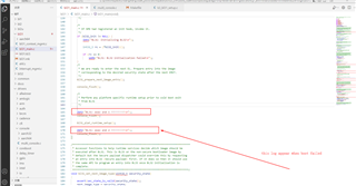

  • I found the code for u-boot-spl.bin and understood the order in which the code was executed
    u-boot-spl.bin :  _start  --> _main --> board_init_f
    If the boot fails, the u-boot-spl.bin command can be used in two cases according to the Log
    1. u-boot-spl.bin is not executed
    2. u-boot-spl.bin is blocked in the satrt or main
    so i want some suggestions from ti

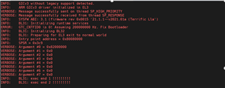

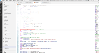

  • i have no jtag and I opened all the logs in bl31.bin and added some logs at the end of the program
    when boot failed , the A72 log as this
    so i think it out of the ATF
