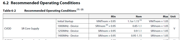

  • Hi g.f.,
    I'll comment on 2 & 3 for now (don't have good answer for #1, Kevin any theories?)
    2. They should not completely disable smart reflex.
    3. One idea would be to increment by ~100 mV, but limit the max programmed value to 1.15V.
    I.e., SRV_used = min(SRV_fuse+100mV, 1.15V).
    This will constrain the maximum voltage to be lower than the value that is in the datasheet for 1400 MHz operation.
    For example if SRV is set to 0.9 V => you would program 1.0V.
    But if SRV is set to 1.1V => You would program to 1.15V.
    Kyle
    The customer's device is a 1 GHz speed grade product, so there is no risk in increasing the CVDD below the 1 GHz operating value (Max) listed in the datasheet, is that correct?
    best regards,
    g.f.
  • 1. No update.
    2. We do not recommend disabling smart reflex.  There is a potential reliability impact, such as a reduction in POH.
    3. Correct.  As long as they don't exceed the MAX nominal voltage allowed for the 1.4 GHz device (which is the same silicon), which is 1.15V.
    Kyle
  • Hi Kyle,
    Thank you for the reply.
    >3. Correct. As long as they don't exceed the MAX nominal voltage allowed for the 1.4 GHz device (which is >the same silicon), which is 1.15V.
    I thought the CVDD voltage was allowed up to the maximum voltage of 1 GHz.
    Since the 1GHz and 1.4GHz products are the same silicon, I understood that they can raise the voltage
    as long as it is up to the 1.4GHz maximum voltage. In other words, they are allowed to raise CVDD
    up to 1.15V instead of 1.1V. Am I correct?
