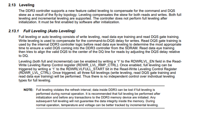

    Here you go...
    Page no : 36 in https://www.ti.com/lit/ug/sprugv8e/sprugv8e.pdf
    2.13.4 Programming Full Leveling
    Leveling (both full and incremental) is executed separately for each byte lane (clock-DQS pair). Therefore,
    the leveling process converges separately for each byte lane. To ensure that leveling converges correctly,
    the DDR3 controller must be given an initial set of values to use during leveling. The leveling process uses
    these initial values to arrive at a set of converged values for each byte lane. These initial values should be
    plugged into a set of memory-mapped registers in the Boot configuration section.
    The user should note that the DATAx registers in steps 2 and 3 below map to specific byte lanes as
    follows (note the difference between C665x and other device variants). The mapping is consistent for write
    leveling and gate leveling initial values i.e. DATA n_PHY_WRLVL_INIT_RATIO and DATA
    n_PHY_GATELVL_INIT_RATIO map to the same byte lane. DATA m_PHY_WRLVL_INIT_RATIO and
    DATA m_PHY_GATELVL_INIT_RATIO map to the same byte lane.
    Table 2-16. DATAx register to byte lane mapping - Page no : 36 in https://www.ti.com/lit/ug/sprugv8e/sprugv8e.pdf
    The steps to program full leveling are as follows:
    1. Unlock the Boot configuration module by writing 0x83E70B13 to the KICK0 and 0x95A4F1E0 to the
    KICK1 registers.
    2. Program the write leveling initial values into the DATA0_PHY_WRLVL_INIT_RATIO to
    DATA8_PHY_WRLVL_INIT_RATIO fields of the DDR3_CONFIG_2 to DDR3_CONFIG_10 registers
    respectively. (See the tables in sections Section 4.33 to Section 4.41).
    NOTE: The values to enter into the registers depend on the board topology and the DDR3 clock
    frequency in use. The DDR3 clock frequency (half the data rate) and trace lengths for each
    byte lane (CK-DQS pair) should be plugged in the appropriate fields in the accompanying
    PHY calculation spreadsheet which generates the values to be programmed into the boot
    config registers mentioned above.
    3. Program the gate leveling initial values into the DATA0_PHY_GATELVL_RATIO to
    DATA8_PHY_GATELVL_RATIO fields of the DDR3_CONFIG_14 to DDR3_CONFIG_22 registers
    respectively. (See the tables in sections Section 4.43 to Section 4.51.)
    4. Program CMD_PHY_DLL_LOCK_DIFF field in DDR3_CONFIG_0 register to 0xF.
    (See Section 4.31.)
    5. Enable global leveling (Set RDWRLVL_EN = 1 in RDWR_LVL_RMP_CTRL).
    6. Trigger full leveling (Set RDWRLVLFULL_START = 1 in RDWR_LVL_CTRL).
    7. Read back any of the DDR3 controller registers.
    This ensures full leveling is complete because this step is executed only after full leveling completes.

  • Hi Shankari,
    Thank you for the reply.
    I understood that the parameter of spreadsheet are appropriate to the DDR3 PHY Leveling registers.
    But I still don't understand what kind of process will these parameter be used.
    From "Keystone I DDR3 Initialization" document page.2 "1.2 Automatic Leveling Initialization"
    it's written as follow:
    The DDR3 PHY Calc spreadsheet is provided to help users calculate the initial values and to translate
    them into the proper units. The inputs are the routed clock and data strobe lengths. The result values are
    the initial values in units of DLL taps, of which there are 256 per clock period. In addition, because the
    initial leveling algorithm adapts only in the positive direction, the initial values are offset 128 DLL steps in
    the negative direction.
    From above information, I thought that each byte lane of C6678 DDR3 controller have DLL to adjust the delay.
    And the values calculated by the spreadsheet will be used as initial value of the DLL.
    And after automatic leveling starts, the delay will be adjusted by DLL based on inital value.
    Is it correct?

  • g.f.,
    Here, when I open and see the spread sheet, "DDR3 PHY Calc V11.xlsx", the yellow coloured cells are the ones which are editable by the user .
    The values of registers like "DATA8_WRLVL_INIT_RATIO " are not editable  and they are automatically calculated by the input values given by the user on the yellow coloured cells ----- following the input instructions given in sheet no : 2 on " Instructions to determine the initial values for levelling.
    1.When the full cycle ratio is  "256 ", the value gets calculated automatically by the Excel sheet as "128" in " DATA8_WRLVL_INIT_RATIO " register
    2. It is better to input the values as per the "9" instructions given in the instruction sheet of the Excel.
    Is it correct?
    Yes, the values calculated by the spread sheet will be used as the initial value of the DLL.

    >> Q5.To use full leveling, I guess incremental leveling are needed after full leveling because
    >> of errata advisory 9 workaround 3.
    >> In Keystone I DDR3 Initialization(sprabl2e) page.16, it said as follow:
    >> Example 25. Incremental Leveling After Full Automatic Leveling
    >> RDWR_LVL_RMP_WIN = 0x00000502;
    >> RDWR_LVL_RMP_CTRL = 0x80030300;
    >> RDWR_LVL_CTRL = 0x7F090900;
    >> Does this setting mean workaround 3 of advisory 9 ?

    I have additional questions about Full Automatic Leveling.
    Q6.
    To use Full Automatic Leveling in C6678, there are errata(advisory 9) and
    I understood that I need to implement the workaround 3 of advisory 9 which uses incremental leveling.
    And previously, I'm asking you that the example 25 "Incremental Leveling After Full Automatic Leveling" written in
    "KeyStone I DDR3 Initialization" will be the workaround 3 or not. In this application note it said that
    "Incremental leveling of at least the read eye sample point must be executed at least 64 times after full automatic leveling
    to converge it to an initial optimum value."But I'm not quite understand that how to excute at least 64 times after full leveling.
    Is it mean that after execution of Exmaple 25, we need to implement some delays to wait for
    the incremental leveling to execute 64 times? If yes, could you provide sample code for this?

  • Hi g.f,
    After reading the errata you pointed to (Advisory 9), maybe the only control of the data to strobe timing is in CONFIG_23, and maybe this is applied to all data lanes. Then, can you please have the customer try adjusting the lower 8 bits ([7:0]) of CONFIG_23 from the default value of 0x34 to values slightly larger and smaller to see if the failure occurs more frequency or less frequently? Note that I only assume 0x34 is the default value as that is what the errata claims. I would have to check with our design team to confirm; however, the easiest solution would be to read this directly from silicon (which the customer could do).
    Regarding the work-around #3, yes it sounds like you would just have to implement a delay (such as a timer) before accessing DDR. My understanding is that the incremental leveling prescalar and interval fields would be used to determine the delay required. However, I think we should first understand whether adjusting the read DQS slave ratio even has any impact on the failure. If there is no impact, then I do not think it makes sense to try and apply work-around #3.
    Kevin
