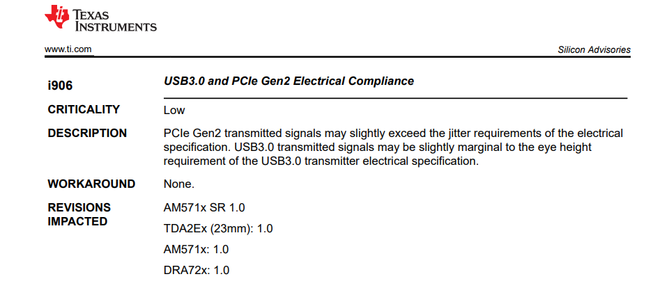

They have revision 1 processors mounted on the cards. And they have seen that there is a PCIe errata in the revision, specifically:
Could the problem be due to this error and that it works on some cards and not on others?
Any other idea on where the problem may be coming from?

    Thanks for the clarification. Link can be lost due to several reasons - either due to change of signal conditions, due to marginal clock jitter as mentioned in the errata, or, the EP device went to low power modes. Below are some thoughts to debug further:
    1. Before freezing, use lspci command to query the capability of EP, to verify if ASPM is enabled.
    2. If you have JTAG access to the board, you can connect CCS to the AM57, without any GEL, to query what is the LTSSM state when device is frozen. or, if you have another core that is still alive, you can read the same register from that core.
    3. if you other ways to connect to the EP device, check what is the LTSSM status of the card. It might be stuck in quiet mode.
