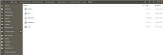

    Also, I saw that in /post/drivers there are 4 tests which are flash.c, i2c.c, memory.c and rtc.c. Are these tests used for testing the MCU? How can I access and use these test scripts?

  • Hi Lit Zhi
    Is the software you snapshotted from Linux SDK or from MCU SDK? From your snapshot this appears to be something in Linux SDK, however most of the POST code that you are snapshotting is for PowerPC and not ARM.

    The path for the snapshot above is /home/litzchee/ti-processor-sdk-linux-am62xx-evm-08.04.01.03/board-support/u-boot-2021.01+gitAUTOINC+2dd2e1d366-g2dd2e1d366/post/drivers. This is from Linus SDK and the subfolder is in uboot, so I think the post tests can be enable and used in uboot. I am interested in running the memory test script (memory.c).
    Regarding the previous reply by Mukul, all architecture should run POST, according to this link u-boot/README.memory-test at master · ARM-software/u-boot · GitHub. Can you guide me on how to enable this generic POST test?

  • Hi Lit,
    CONFIG_POST has never been enabled in U-Boot for any TI processor. This config is not supported in Processor SDK.
