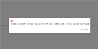

There is an error when I import the j721e-evm.syscfg file in “k3-respart-tool” using sysconfig tool. Please help to solve it. Thank you.
    I checked with our expert. Here is the feedback:
    In the desktop version of the tool, if the user has never used the k3-respart-tool before, then one cannot simply open an existing .syscfg script that makes use of that tool.  One will instead have to browse for that product, then select file->open and select it.  Afterwards, can pick the .syscfg file from the start page.

  • Hi, Keerthy
    I'm sorry I don't understand you. We really haven't used k3-respart-tool before, could you please give us a detailed procedure for using it?
    In addition, I have executed the "./scripts/setup.py -s /path-to-sysconfig-installation "command, and the execution is successful.
  • Hi, Keerthy
       Problem solved, thanks for your help
