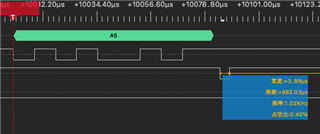

Hi,we are testing uart driver and find out the UART Interrupt function: UART_v1_hwiIntFxn() will take more than 3.8us to process,so when we have amount of data coming in(eg:460800bps,9KB/sec of data), the system will not be real time, and this will make our application unuseable, we want to know why the uart ISR take so much time, and is there any solution for this?
alse we want to know how to enable uart rx fifo, we use UART_read(gUARTHandle,(void *)(uintptr_t)rxData,16); to read multiple bytes but found out it still enter ISR every single byte.
the second Chanel indicate how long it take to process the ISR using gpio write.
our test case
JasonZhang
  • we set gpio to low when enter ISR,and set gpio to high when exit ISR,here is the code in pdk_jacinto_08_02_00_21/packages/ti/drv/uart/src/v1/UART_v1.c

  • Hello Jason,
    Here are some suggestions to your problems.
    For the time consuming problem of  UART_v1_hwiIntFxn(), the 3.8us includes both the time cost of the interrupt function itself and the time cost of your GPIO application. Normally, the GPIO application takes greater time cost. You may need to add a timer to record the time cost of GPIO application, then use 3.8us to minus the result to obtain the time cost of interrupt function.
    As for the UART RX FIFO problem, I think you may need to add the interrupt enable coding: uart_cfg.enableInterrupt=1; /* Enabling interrupt forcefully */ in your UART_initConfig function. The position of this coding should be between UART_socGetInitCfg(uartTestInstance, &uart_cfg) and UART_socSetInitCfg(uartTestInstance, &uart_cfg). If we do not enable the interrupt, the interrupt will not be used to read from FIFO, and in this situation, the driver will directly read from the FIFO, one byte at a time. This might be the reason why it accesses ISR every single byte.
    Hope this will help.
