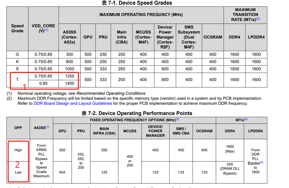

    一、There are two questions about the following table:
1. In the red box 1, why does the letter“ T ”have two frequencies that can be configured by the customer through software? How to configure? Are the two frequency hardware the same?
2. In the red box 2, how are High and Low defined or distinguished from hardware?

  •  Hello Rain Wang
    Thank you for the note and appreciated. Please refer below inputs
    #1 is hardware – speed grade T devices support A53SS operating at 1400 MHz only when the core supply is 0.85V.  The max operating frequency is 1250 MHz when the core supply is 0.75V.  The value “0.75/0.85” was included in the table to show 1250 MHz is valid option for either operating voltage.
     We have been debating if we should remove value “0.75/0.85” and replace it with “0.75”.  I think it is understood any frequency lower than the max is a valid operating condition for A53SS.
     #2 is software, no hardware distinction – these operating points are defined by software.  I think the primary purpose is to offer a power saving operating mode.
    Sreenivasa
  • Hello Rain Wang
    Here are some additional inputs
    The core voltage is fixed in the hardware. Customers need to choose the voltage when they design the hardware. It will also be influenced by device speed grade choice. The software will limit the max frequencies based on the speed grade information in the eFuse.
     Speed Grade T can support the highest clock frequency. It’s 1250 MHz at 0.75V and 1400 MHz at 0.85V. 1250 MHz at 0.85V can be an option if customers want to combine VDD_CORE and VDDR_CORE to reduce the number of power supplies. There is no limitation to using 0.75V for the 1250 MHz clock frequency.
     OPP High is the standard operating point. OPP Low is a lower power operating point by reducing interconnect clock frequency w/ reduced interconnect performance. It’s a choice by the software.
    Sreenivasa
