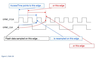

    Rule 3. (RDACCESSTIME – CLKACTIVATIONTIME) modulus (GPMCFCLKDIVIDER + 1) must be different from GPMCFCLKDIVIDER
    This is a consequence of the internal sampling scheme in OMAP3 (see block diagram above). Violating this rule will not result in broken functionality, but rather in a limitation in the maximum GPMC_CLK frequency.
    Figure 1 illustrates the sampling timing when Rule 3 is followed. The blue traces show the case where (RDACCESSTIME - CLKACTIVATIONTIME)%2 = 0, the red traces show the case when (RDACCESSTIME - CLKACTIVATIONTIME)%2 = 1.

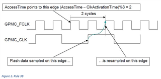

    Figure 2 shows an example where Rule 3 is violated. The data is re-sampled only one clock cycle after the initial sample.
    Figure 3 shows an example where Rule 3 is violated. Again, the data is re-sampled only one clock cycle after the initial sample.
