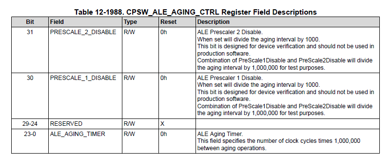

We are looking for procedure to set ALE_AGING_TIMER to 10sec.
By default, we read value of this register as 0x141(321 dec).
Thinking number of clock cycles might be for R5F processor (1GHz). Our understanding is default value is
 (10^-9)*(1000000) *321= 0.321 sec
Please let us know if our understanding is correct?
