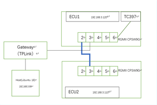

When two switch port send large-udp-package(6400 bytes) to Linux PC  simultaneously, udp package from ECU loss seriously.
we tested flowing testcases with topology(topology.png):
    Host:
iperf3 -s -p 5201
iperf3 -s -p 5301
    ECU1:
iperf3 -c 192.168.3.99 -p 5201 -b 30M -t 20 -u -l 6400
    ECU2:
iperf3 -c 192.168.3.99 -p 5301 -b 30M -t 20 -u -l 6400
case 1: ECU1 send UDP, ECU2 do nothing, PC receive UDP
case 2: ECU1 do nothing, ECU2 send UDP, PC receive UDP
case 3: ECU1 send UDP, ECU2 send UDP, PC receive UDP
    Test result: When ECU1 and ECU2 Send separately(case1 and case 2), udp packages donot loss. When ECU1 and ECU2 send simultaneously(case 3), ECU2 udp package loss Seriously。

    The test env is:
    On ECU2, the port 6 is not connected(the ECU2 code was ported from ECU1, some configuration is same as ECU1).
    From the CPSW port stats, i don't find great packet loss information when this case reproduces.
    The code of this port stats was ported from  cpsw_stats_print_regs.gel;
    string "#15" means "\n" (The log output converts "\n" to "#15")

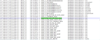

  • Dear Zhongxin,
         1. Could you try to use iperf rather than iperf3?
         2. As we talked before, this only happens while transferring large package. The TX FIFO Queue size is 2K Bytes. Therefore, when large number of packets need to be forwarded, it is possible that the packets are dropped due to exhaustion of the Queue. This might be a possible cause for the issue. An alternative would be to try using VLAN to assign packet priority to the traffic from ECU2. With this, ECU1's traffic to PC will be sent on TX Queue 0 while ECU2's traffic will be forwarded to PC on TX Queue 1 (If VLAN priority is 1). Or you can try to enlarge the fifo size to see if this could be improved. Please pay attention that when you enlarge the fifo size here you need to reduce the memory size somewhere else.
         3. I still see "#" characters in your log. Could you directly read the value of
    RX_BOTTOM_OF_FIFO_DROP
    RX_TOP_OF_FIFO_DROP
    ALE_OVERRUN_DROP

  • udp.issue.all.regs.iperf3.log.new.tar.gz
    Hi Sikai,
    1. I will upload the iperf test result after finished the iperf test.
    2. I will try using VLAN to assign packet priority. if you have examples, can you provide them to us ?
    3. Update the cpsw stats information, RX_BOTTOM_OF_FIFO_DROP/RX_TOP_OF_FIFO_DROP/ALE_OVERRUN_DROP value can be found in files testcaseX_PORT.log

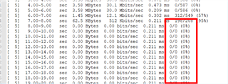

    From the case3 iperf3 client test log, we can see packet loss:
    but the log of tcpdump on PC show no kernel drop:

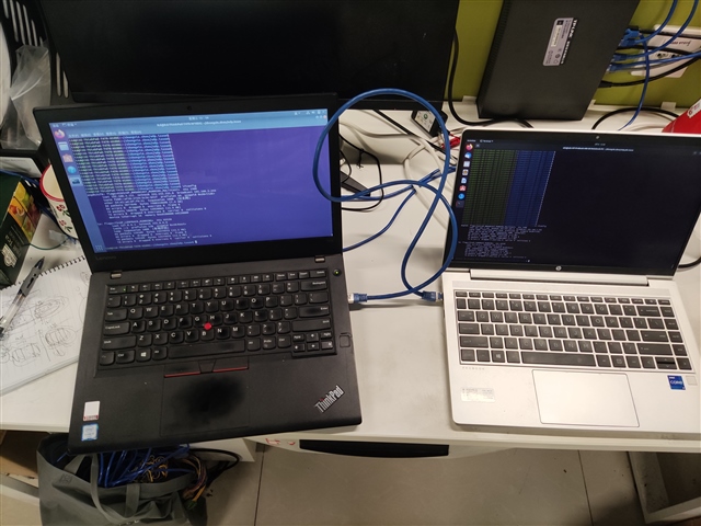

         4.  They also run same test between to laptop, here is their test environment
             We can see from the test vedio that there are huge packet drops in tcpdump while iperf is running well:
    BR
    Sikai

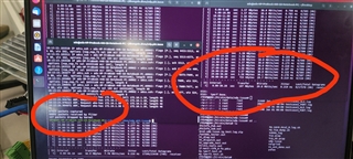

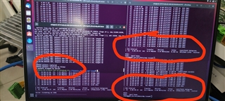

  • Dear Siddharth,
        Here is customer's test today, they use SDK 8.2 Linux, PC ---- Transceiver(100M) ----- ECU1 (TC397) ------ ECU2
        1. TC397 has some background noise, to test that we run a test at the beginning of the vedio. No iperf3 process was running and we can see 600+ packets captured by  TCPDUMP with 0 packet drop. So we think this background task will not affect the number of packet drop.
        2. After reproducing the error and check the TCPDUMP, we can see 700+ packets dropped out of 65000+ captured.
    iperf3 -c 192.168.3.99 -p 5201 -b 30M -t 20 -u -l 64000 -T Linux-ECU1 --get-server-output

    [  5]   0.00-1.00   sec  0.00 Bytes  0.00 bits/sec  0.000 ms  0/0 (0%)
    [  5]   1.00-2.00   sec  2.14 MBytes  17.9 Mbits/sec  11672251871.845 ms  1/36 (2.8%)
    [  5]   2.00-3.00   sec  7.45 MBytes  62.5 Mbits/sec  4442734.811 ms  18/140 (13%)
    [  5]   3.00-4.00   sec  3.54 MBytes  29.7 Mbits/sec  105192.526 ms  0/58 (0%)
    [  5]   4.00-5.00   sec  3.60 MBytes  30.2 Mbits/sec  2335.135 ms  0/59 (0%)
    [  5]   5.00-6.00   sec  2.20 MBytes  18.4 Mbits/sec  228.794 ms  0/36 (0%)
    [  5]   6.00-7.00   sec  0.00 Bytes  0.00 bits/sec  228.794 ms  0/0 (0%)
    [  5]   7.00-8.00   sec  0.00 Bytes  0.00 bits/sec  228.794 ms  0/0 (0%)
    [  5]   8.00-9.00   sec  0.00 Bytes  0.00 bits/sec  228.794 ms  0/0 (0%)
    [  5]   9.00-10.00  sec  0.00 Bytes  0.00 bits/sec  228.794 ms  0/0 (0%)
    [  5]  10.00-11.00  sec  0.00 Bytes  0.00 bits/sec  228.794 ms  0/0 (0%)
    [  5]  11.00-12.00  sec  0.00 Bytes  0.00 bits/sec  228.794 ms  0/0 (0%)
    [  5]  12.00-13.00  sec  0.00 Bytes  0.00 bits/sec  228.794 ms  0/0 (0%)
    [  5]  13.00-14.00  sec  0.00 Bytes  0.00 bits/sec  228.794 ms  0/0 (0%)
    [  5]  14.00-15.00  sec  0.00 Bytes  0.00 bits/sec  228.794 ms  0/0 (0%)
    [  5]  15.00-16.00  sec  0.00 Bytes  0.00 bits/sec  228.794 ms  0/0 (0%)
    [  5]  16.00-17.00  sec  0.00 Bytes  0.00 bits/sec  228.794 ms  0/0 (0%)
    [  5]  17.00-18.00  sec  0.00 Bytes  0.00 bits/sec  228.794 ms  0/0 (0%)
    [  5]  18.00-19.00  sec  0.00 Bytes  0.00 bits/sec  228.794 ms  0/0 (0%)
    [  5]  19.00-20.00  sec  0.00 Bytes  0.00 bits/sec  228.794 ms  0/0 (0%)
    [  5]  20.00-20.00  sec  0.00 Bytes  0.00 bits/sec  228.794 ms  0/0 (0%)
    [ ID] Interval           Transfer     Bandwidth       Jitter    Lost/Total Datagrams
    [  5]   0.00-20.00  sec  0.00 Bytes  0.00 bits/sec  228.794 ms  19/329 (5.8%)
