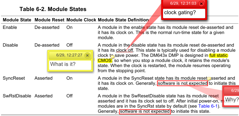

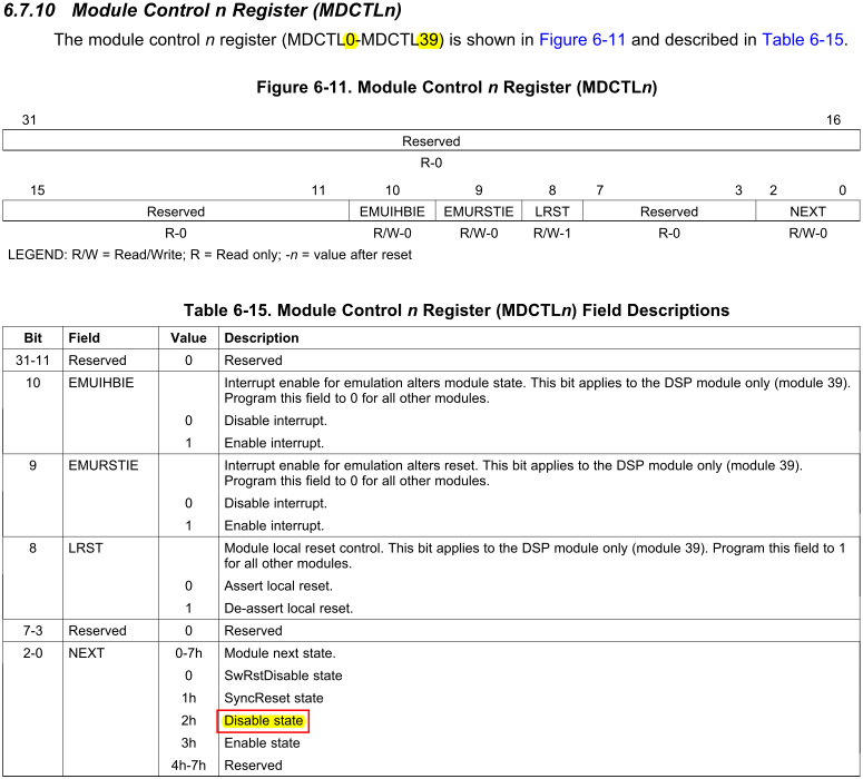

On page 75 of SPRU978E, TMS320DM643x DMP DSP Subsystem:
Question 2
What does the values of NEXT mean here? Does “2h Disable state” correspond to “clock gating” or “power down”, or else? What does
1.    SwRstDisable
2.    SyncReset
mean, respectively?

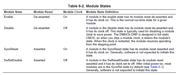

    For Question 2, each state is clearly defined in SPRU978.

    1.    Does “module clock off” mean clock gating?
    2.    What is “full static CMOS”?
    3.    For SyncReset and SwRstDisable, both description says that they are “not expected to be initiated by software”. Their common characteristic is with module reset asserted, so do they exist only when user pressing a reset button, or during the short interval before or after booting?
