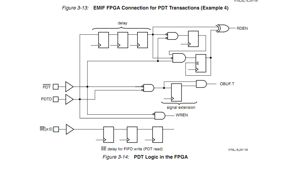

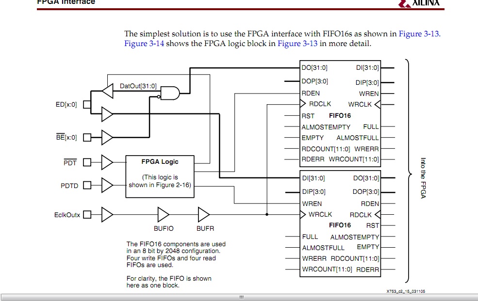

Hello Everyone,
I am trying to do a Peripheral Device Transfer (PDT) from an FPGA (FIFO on a Virtex-5) to a DSK6416. The data is 8-bit and fifo depth is 32.
The FULL flag of the FIFO will trigger a PDT (an EDMA event). The FULL flag of the FIFO is connected to EXT_INT7 which will trigger the EDMA event EDMA_EVT_EXTINT7 ( channel # 7 of C6416T ).
The FIFO worked perfectly in simulation as well as on the Virtex-5. It runs on ECLKOUT. ( I checked ECLKOUT by running a counter on the FPGA ).
Connections between DSK and FPGA were setup according to XAPP753(I've attached the screenshot of the setup.)
Initially I tested to see whether the FULL flag is interrupting the CPU or not and it did.
The problem is when I programmed the EDMA for channel 7, the FULL flag did not trigger the event. ( It did not set the EDMA EVENT SET register  - ESR w.r.t channel 7 ).
So I tried to set the ESR (to trigger the event) by using EDMA_setChannel( handle) or EDMA_RSET(ESRL,value). This neither set the bit in the ESR nor did it change the corresponding bit in the Event Register (ERL). I tried another channel as well but that didn't work too. Does anyone have any idea what could be the reason ?
I have attached my code and a screenshot of the FPGA-DSP connection.
Even after setting up the CE space 0 as 8-bit wide SDRAM, BE signal wasn't driven LOW. Any help would be greatly appreciated. Thanks in advance.
