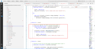

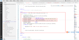

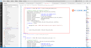

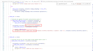

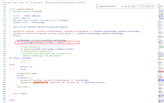

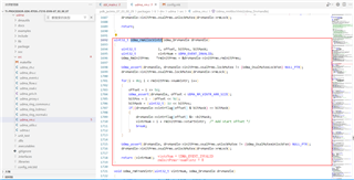

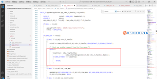

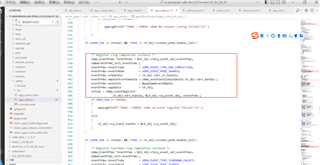

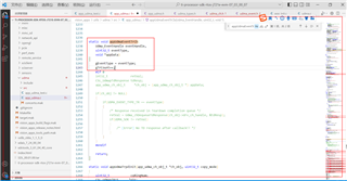

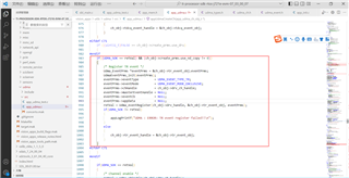

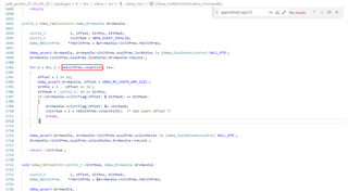

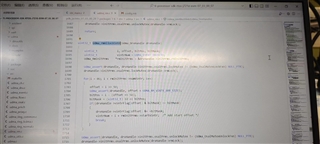

1. i use appUdmaCopyNDGetHandle() function to get dma channel , but I find that when i call more than 8 times, an error  (VINTR alloc failed )has occurred. as the image show.
and i find it because rmInitPrms->numVintr is 8, so I can't call it more than 8 times. as image show .
2. I would like to know if I can configure this (rmInitPrms->numVintr) and how

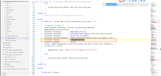

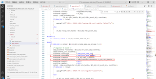

    You could allocate more interrupts in the resource manager. But why do you require more than 8 interrupts on C6x? Can you please try using shared interrupts, instead of exclusive interrupts?
    You could use shared event and then can use master Event handler as shown below.
    cqEventPrms.eventMode = UDMA_EVENT_MODE_SHARED;
    cqEventPrms.masterEventHandle = Udma_eventGetGlobalHandle(drvHandle);

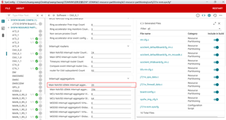

  • Dear Brijesh,

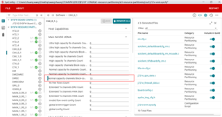

         Thanks for your guide , here is our change result:
        It reports "exceed" error, is it caused by mis-operation?
    BR
    Sikai
  • Hi Sikai,
    All resource are fully allocated by default. So if you need any additional resource, you need to first reduce them from other core and then can allocate in this core. Lets say if you require UDMA RX channels on C6x, you need to reduce them from another core and then can allocate them on C6x core.. This error will then go away.
    Brijesh

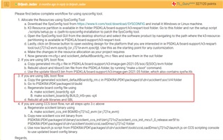

    But which component is loading QNX on A72? Is it SBL or uboot? If it is SBL, please update the sciclient_boardcfg_rm.c file in the PSDKRA/pdk, rebuild boardcfg and then SBL and then try loading QNX. If it is SPL/uboot, please generate rm_cfg.c file, update it in k3-image-gen-2022.01/soc/j721e/evm/ folder, rebuild uboot and sysfw.itb and then use updated uboot to load QNX.
    I see customer is updating it in the PDK, which is part of psdkqa. This is not correct place. Depending on which component is loading QNX, please update the appropriate component..
    Brijesh

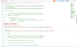

  • 1. we use SBL boot mode, and HLOS_BOOT = development

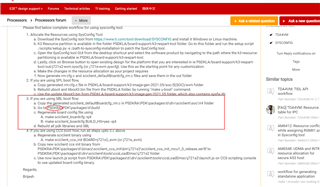

    2. now , we update sciclient_defaultBoardcfg_rm.c in PSDKQA\PDK\packages\ti\drv\sciclient\soc\V1 folder and step c complete success.
    but there are some questions about step d, I need to compile SBL, but  what image do I need to rebuild to generate in SBL, is it tiboot3, u-boot.img, or tifs.bin
  • You only need to rebuild SBL and rename it as tiboot3.
    Since you are using SBL and boot from EMMC please refer to this graph:
    This tiboot3 is different from what you built from Linux SDK.
    BR
    Sikai

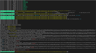

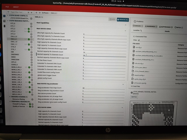

  • 1.  i increase DSP C66_0 UDMA channel count to 14 in sysconfig , and get sciclient_defaultBoardcfg_rm.c
    2.  update sciclient_defaultBoardcfg_rm.c in PSDKQA\PDK\packages\ti\drv\sciclient\soc\V1 folder
         make sciclient_boardcfg -sj4
         make sciclient_boardcfg BUILD_HS=yes -sj4
    3. rebuild tiboot3.bin and replace in emmc
    but error  (VINTR alloc failed ) still  occurred

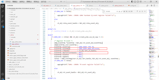

  • Dear Brijesh,
         To check whether this is a compling issue we tried to decrease the channel to 6 rather than increasing.
         Customer doubt that the problem may be caused by lack of interrupt instead of channels.
    Dear Chuang,
         1. Could you share the configuration of 6 channels and how you confirm that you have passed the compling?
         2. Could you share the current error configuration?
    BR
    Sikai
  • 1.  I modefi the generate .h file in ti-processor-sdk-rtos-j721e-evm-07_03_00_07\pdk_jacinto_07_03_00_29\packages\ti\drv\sciclient\soc\V1 folder ,  and rebuild pdklib failed , so i think it compiled these files when build tiboot3
    2. sciclient_defaultBoardcfg_rm.c   dsp_c66_0 decrease the channel to 6

    But are you using SBL boot flow or SPL? Because if you are using SPL, then this needs to be changed in the k3-resource partition tool.
    Please follow steps mentioned on below link for SPL or SBL bootflow.
    https://e2e.ti.com/support/processors-group/processors/f/processors-forum/1097038/faq-tda4vm-workflow-and-resource-allocation-build-flow-for-sysconfig-tool
    Brijesh
  • Dear Brijesh,
         They are using SBL and this is what they did.
    BR
    Sikai
  • SBL mode and make by step 3, but it failed function is Udma_rmAllocVintr, so whether this is caused by the number of interrupts
  • Dear Brijesh,
         Update from Customer side:
         When he changes channel counts, it will show "VINTR alloc failed "
         However when he changes channels block-copy then "alloc failed" error disappers while it stps at "Udma_rmAllocVintr"
         1. Could you help check we do the modification at right position?
         2. They have increased the channels so they think now the problem is the lack of interrupts. Do you mean we can also change the interrupts in Sysconfig? Or even when we change the channel number we have already increase the number of interrupts?
    BR
    Sikai
  • 1. i want know how to increase interrupts count
    2. i try use share interrupt , but i find it still call Udma_rmAllocVintr(drvHandle) and eventHandle->vintrNum is invalid
  • Strange, let me spend sometime today to see where it allocates and why it tries to allocate new VIntr.
    Rgds,
    Brijesh
  • hi,
    i know what cause this , i must assign  value to eventPrms->masterEventHandle, and now it work
  • I thought you are already using master event handler from below statement. isn't it?
    The second statement asks UDMA driver to use common master event handle even for this new event, so it should not now allocate new event and should work fine..
    Brijesh
  • yes, now it work fine by modefi to share interrupt, and i also want know how to increase interrupts count by sysconfig tool, I can't find the corresponding modification item
    You require to increase both of these numbers in order to increase number of virtual interrupt for a core. Below is the number of virtual interrupts supported on mcu2_0 on TDA4VM.
    In order to allocate it more for mcu2_0, you require to reduce it from the other core and allocate it for mcu2_0.
    But i would not recommend using separate virtual interrupt for each channel. If you dont want to use global virtual interrupt, you could allocate one and share it for all the channels.

  • hi,
    we have problems using UDMA, example of reference is appUdmaTestNDCopy() function in vision_apps\utils\udma\src\app_udma_test.c
    i want know what should I modefi if I want to use shared interrupts
    i find Udma_eventRegister() is called three times in appUdmaCreateCh() function, which one do I need to modify
  • Anyway, can we use shared interrupts with NDcopy
  • Not sure why shared interrupts not used for ND Copy. Are you facing any issue with it? Can you try using shared even for it also?
    Brijesh
  • 1. I tested the share interrupt using appUdmaTestNDCopy() in the vision_app  app_udma_test.c.
    2. I modefi the eventPrms->eventMode to UDMA_EVENT_MODE_SHARED,  modefi  eventPrms->masterEventHandle to Udma_eventGetGlobalHandle(ch_obj->drv_handle).
    3. i have no found callback function for TR event, so eventCb and appData is set to NULL.
    4. When I run the demo, appUdmaCopyNDWait was not return
    Is my modification correct, or did I miss something
    Not sure why this is not working. For the time being, can you please continue using exclusive event for ND copy?
    Brijesh
  • hi
    when i reuse exclusive event for ND copy , it work , can you test the share mode
    Not sure why it is not working. I have raised this issue with our team.
    https://jira.itg.ti.com/browse/ADASVISION-5787
    Brijesh
  • hi.
    When I added a callback function I wrote myself, it turned out that the callback function was triggered every time appUdmaCopyNDTrigger was called.
    So, I set the flag bit in the callback function and modified the break judgment condition of the appUdmaCopyNDWait function, in which case appUdmaTestNDCopy runs fine
    I hope this test will be helpful to your analysis, or whether I can operate in this way and whether it is safe
  • But then there is no issue, isn't it? callback function needs to be provided to unblock main task..
    Rgds,
    Brijesh
  • yes it is , but whether it's reasonable for me to do this., I'm worried about errors when multiple channels operate at the same time
  • Yes, it is completely ok. I see you are already passing ch_obj as appData and this is being accessed from the callback function. So even in case of multi-channels, it would work fine and process/unblock correct channel/task.
    Rgds,
    Brijesh
  • hi,
    When the
    appUdmaTestNDCopy function finished, we used the appUdmaCopyDelete function to free the channel resource and found that we could not exit the Udma_ringFlushRaw function
  • tempRetVal is -2
  • This error essentially means bad args ie null pointer.. Which means either ringHandle is incorrect or ring number is incorrect. Can you please check the parameter that are passed to this function? is the getFqRingHandle returning correct ringHandle?
