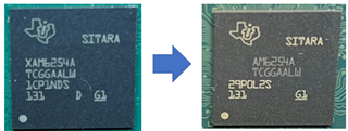

We have problems getting our latest batch with AM6254A up and running, previous once working.
The working once have pre production samples of the micro partnr “XAM6254A…..”
The NOT working once have samples of the micro part nr “AM6254A…..”
The micro is the only thing that differs.

Picture showing micro to the left working and right NOT working
