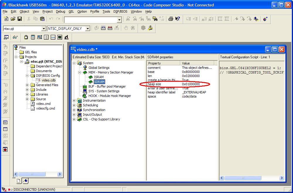

  • As it is crashing like this, it could be that your stack or heap sizes are too small, particularly if you are allocating additional large arrays beyond what the driver is allocating. I would make sure that the arrays you are processing are declared as global so they can be statically allocated, if they are local they would be placed on the stack which would be enough to overflow the stack if left at the default value, alternatively you could increase the size of the stack though for these relatively large buffers it is better practice to just declare them globally (more efficient and less chance of stack issues).

  • I am glad to hear that making the arrays global fixed the crashing issue. As to being slow do you mean just the lag as in a delay/latency from the video input to the video output or do you mean that you are dropping frames? In either case it is possible that you are reaching performance limits of the device, you can probably improve performance a bit by organizing your memory map such that code and data that is accessed most often is stored internally, though since these buffers do not fit in internal memory there will always be a bit of slowdown as the current data being worked on is cached. As to the latency I would expect some due to the buffering being done in the drivers as well as perhaps some latency added by the processing buffering, though this should only be a matter of a few frame delays, a fraction of a second. If the delay is more than a second than you may want to look at your buffering scheme and see if it can be modified to improve the latency (such as avoiding unnecessary data copies).
    The stack and heap sizes can be set within your DSP/BIOS configuration file (cdb or tcf depending on your version), there are controls within the memory section manager for this.

  • I'm using the tcf file as supplied, so I don't know if something is fundamentally misconfigured. I haven't made any changes to it, until now that is. Anyway, the only tab configurable in the Global Settings is 641x. I believe the cache is enabled. I tried playing around with the MAR bits, specifically MAR128-142, as it controls the EMIFA CE0 space (SDRAM), but there doesn't seem to be any difference. Am I doing it right?
    As for stack and heap sizes, the only thing I can find in MEM are "argument buffer size" and "stack size (MAUs)". Is that what you are referring to. Fyi, the default values are 0x0004 and 0x1000 respectively

  • It sounds like you are set for the MAR bits, they determine what external memory is cachable.
    For the stack size you found that already, but the heap size is specific to each memory region you have defined in your BIOS configuration file (you can have multiple heaps with BIOS). For example see the attached screen shot.
  • I tried all Opt Level (-o0 to -o3), but again there doesn't seem to be any difference.
    As for the stack size and heap size, I tried several values. There's some improvement in that with certain values, it doesn't halt prematurely. However, it still displays nothing. The "Trouble Removing Breakpoint" messages are also still there, along with "Trouble Setting Breakpoint".

    This behavior sounds like at some point the CPU begins running invalid code and trashes the system. If you are able to load the program and start stepping through see if you can step through all of the initialization properly and find where the code starts causing those messages.
  • Sorry for the 'late reply'. I just realized that my post the other day didn't get through.
    Anyway, I can only do Assembly-Single Step. Not much help to me (I can't really read assembly codes). The other buttons are greyed out.
    Hanief
