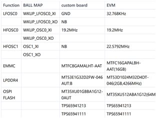

We are development TDAVM HS version with our custom board. And we find that the boot-up timing of TDA4VM HS version is twice of TDA4VM GP version.
Is this reasonable? Is there date reference from TI about the TDA4VM HS version booting up?  For example, the time required to verify the signature of an image.

HW Difference
