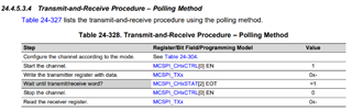

Referring to SPRUHZ6L–October 2014–Revised August 2019  page 9577 the customer believe that:
1) "stop the channel should be the last step - after all receive has been done
2) The register for the line "Read the received register" should be MCSPI_RXx
The customer  based this on Table 24-325 (Receive-only procedure - polling method)
Would Please confirm if the customer's interpretation is correct?

  • Hi Marvin,
    There is no page 9577 is the mentioned document.
    Can you please provide the section name and number your customer is referring to?
    Parth

  • Hi Parth,
    Thank you for waiting. Here is some clarification:
    The correct page is 5977. The customer is referring to the
    1. “stop the channel” before “Read the received register”
    2. “Read the received register”  refers to Register MCSPI_Txx and not MCSPI_TXxx

  • Hi Marvin,
    I don't believe that's necessary. You can refer to our PDK driver, there the channel is disabled after that RX register has been read. But just to double check, I am looping in our McSPI experts for the confirmation.
    Yes, this is correct understanding.
    Parth

  • I believe you meant to reference the MCSPI_RXx registers instead of MCSPI_Txx?
    Agree that you don't need to disable the channel before reading the RX register.
    To clarify your response, does this mean that "the channel should only be disabled after reading the RX register”?
    The customer want to know when does the channel need to be enabled and when should it be disabled.
    What does not work if the channel is disabled what only works when it is enabled.

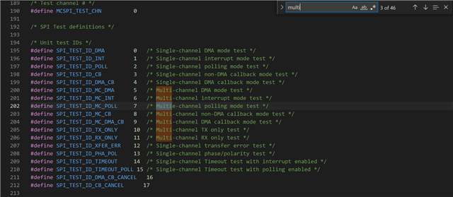

    Also - is there an example of using the system in non-single channel mode ? Is it really as simple as changing SPI_v1_HWAttrs . chMode from  MCSPI_SINGLE_CH to MCSPI_MULTI_CH and using the existing checks on . chMode  and   MCSPI_SINGLE_CH.?
    Please refer to the example available at <PDK>\packages\ti\drv\spi\example\mcspi_slavemode\src
    There are UTs available for MultiChannel mode as well
