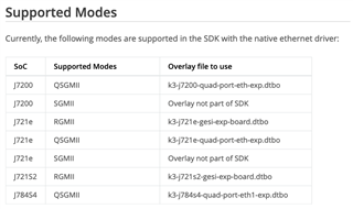

We are looking for working examples of device tree overlays for SGMII support on the TDA4VM.
In the following appnote:
/cfs-file/__key/communityserver-discussions-components-files/791/CPSWng-Native-Ethernet-_1420_-Processor-SDK-Linux-for-J7200-Documentation_5B00_3_5D00_.pdf
It is mentioned that SGMII support has been validated on TDA4VM (J721E), but that support for this is not included in the SDK.
Can you please provide an example of SGMII in a device tree? Bonus points if you can also provide a description of how the SGMII PHY was connected to the TDA4VM serdes (e.g. identify the serdes port and clocking scheme).
Thanks!
  • Thanks. However, the question was concerning specifically an overlay that would enable SGMII on TDA4VM (any port - it doesn't matter which one). You have overlays for QSGMII and RGMII on TDA4VM. We are looking for an SGMII overlay example. Thanks.

  • Hi Robot,
    Sorry for delayed response.
    Our team has reviewed your request and provided following suggestions.
    The following needs to be added within the Serdes4 device-tree node:
    serdes4_sgmii_link: phy@0 {
            reg = <0>;
            cdns,num-lanes = <4>;
            #phy-cells = <0>;
            cdns,phy-type = <PHY_TYPE_SGMII>;
            resets = <&serdes_wiz4 1>, <&serdes_wiz4  2>, <&serdes_wiz4 3>, <&serdes_wiz4 4>;
    Also, CPSW ports 5-8 should have the following contents:
    &cpsw0_port5 {
            phy-mode = "sgmii";
            mac-address = [00 00 00 00 00 00];
            phys = <&cpsw0_phy_gmii_sel 5>, <&serdes4_sgmii_link>;
            phy-names = "portmode", "serdes-phy";
            phy-handle = <&cpsw9g_phy0>;
    &cpsw0_port6 {
            phy-mode = "sgmii";
            phys = <&cpsw0_phy_gmii_sel 6>, <&serdes4_sgmii_link>;
            phy-handle = <&cpsw9g_phy1>;
    &cpsw0_port7 {
            phy-mode = "sgmii";
            phys = <&cpsw0_phy_gmii_sel 7>, <&serdes4_sgmii_link>;
            phy-handle = <&cpsw9g_phy2>;
    &cpsw0_port8 {
            phy-mode = "sgmii";
            phys = <&cpsw0_phy_gmii_sel 8>, <&serdes4_sgmii_link>;
            phy-handle = <&cpsw9g_phy3>;
    Please refer to attached sample reference patch for SGMII device tree overlay.
    https://e2e.ti.com/cfs-file/__key/communityserver-discussions-components-files/791/0001_2D00_arm64_2D00_dts_2D00_ti_2D00_k3_2D00_j721e_2D00_Add_2D00_overlay_2D00_to_2D00_enable_2D00_CPSW9G_2D00_p2_5F00_SGMII.patch
    Sudheer
