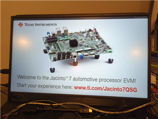

  • Hi Brijesh,
    we are using the display port and it is connected to a monitor running 1080p.  It does appear that the patches exist in U-Boot
    I have an image that i built if I boot it up using the default vision_apps.dtbo and comment it out from the uEnv.txt file and reboot I will get what i am expecting with a weston desktop saying welcome to Jacinto, when I power cycle the unit i end up getting the sync lost error.

  • Hi Brijesh,
    So I built a Processor Linux SDK using 8.05  with patches to U-Boot and the Linux Kernel and have the device booting to linux, it is currently still receiving the CRTC0 SYNC LOST message.  I have attached my dmsg log to the bottom of the post, the frame buffer and DRM seem to startup fine and kmsprint thinks we are connected.
    root@j7-evm:~# kmsprint
    Connector 0 (39) DP-1 (connected)
    Encoder 0 (38) NONE
    Crtc 0 (37) 1920x1080 148.500 1920/88/44/148 1080/2/5/38 60 (60.00)
    Plane 0 (31) fb-id: 60 (crtcs: 0) 0,0 1920x1080 -> 0,0 1920x1080 (AR12 AB12 RA12 RG16 BG16 AR15 AB15 AR24 AB24 RA24 BA24 RG24 BG24 AR30 AB30 XR12 XB12 RX12 AR15 AB15 XR24 XB24 RX24 BX24 XR30 XB30 YUYV UYVY NV12)
    FB 60 1920x1080
    I did notice the below line in the dmesg, could this be causing the sync error?
    [    7.558420] tidss 4a00000.dss: vp0: Clock rate 600000000 differs over 5% from requested 148500000

  • Hi Jayesh,
    when i null out edid, i do not get the sync error anymore.  I don't have a display showing but that can be the monitor, I am still getting a clock rate mismatch error
    [  128.952584] tidss 4a00000.dss: vp0: Clock rate 600000000 differs over 5% from requested 65000000
    apparently the tidss settings on the RTOS side are working since I can get a display up and running via the R5 core, I am going to try to override the ti-dss settings with the the 1080p settings used in the RTOS code and see if that fixes things.
    Thank You,
    George
