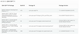

  • Hi Priyank,
    The Release notes for PSDK QNX 8.5, specify that Screen Package 3.2 was used in testing, and that QNX/Blackberry needed to be contacted for access.
    This would mean that at the time TI tested and released PSDK 8.5 the 3.2 Screen package was available to TI, however the 3.2 Screen package had not been uploaded to QNX Software Center (QSC) by QNX.
    4.1. Release notes - 08_05_00 — Processor SDK QNX J721E (ti.com)
    In checking on my local machine, the screen package is now available for download from QSC.
    Recommend downloading the Screen 3.2 package from QSC, and the folder discrepancy mentioned should be resolved.   If your version / view of QSC is not showing Screen 3.2, then recommend reaching out to QNX/Blackberry.
