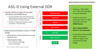

I see from TI website (Reference: Additonal ASIL-D performance_DRAM.pdf), following slide which talks about black channel to identify several failure modes of DDRRAM controller.
I don't see any information related to such diagnostic measures either in TI Safety Manual or TRM of TDA4VH.
Could you please provide more details/documentation on this black channel in TDA4VH.

  • Hi Srinivas,
    Could you please provide a link to the referenced document, I was not able to locate it on an initial search.

  • Hi KB,
    Sorry, I couldn't recollect the website/online pdf info from where I took this snapshot.
    Ignore the diagram. Information I need to know is if TI used any black channel implementation to check faults against DDRRAM controller?
    If yes, could you please share more information on this topic.
