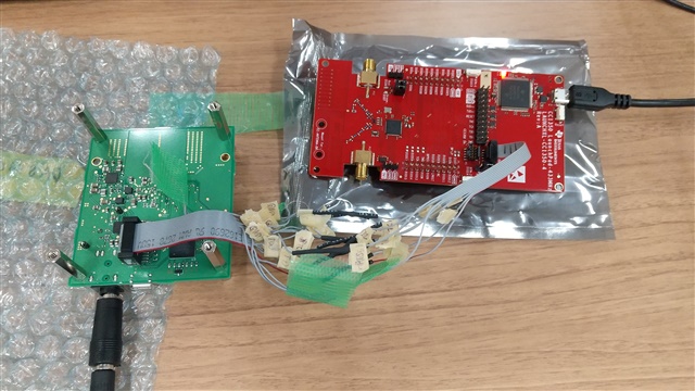

Write the program to TM4C129ENCZAD (IC on custom board) using LAUNCHXL-1350.
I want the TM4C129 to have the functionality of StandAlone's XDS110.

First I set the Target Configuration.
I connected with the following settings.
And I chose Core. (CORTEX_M4_0)
After this, I did a Test Connection and got the following response.
The JTAG DR Integrity scan-test has succeeded.
[End: Texas Instruments XDS110 USB Debug Probe_0]
Next, I connected the target and the Debugger.
Are there any problems with the steps up to this point?
2. Program load
It's the .axf file I mentioned before.
Then the console file showed the following results:
What could be the cause?

The default behavior of CCS debugger is to auto-run to the 'main' function on program load. But if the program that is loaded does not have a 'main' function, then you will get the message you see and the program will continue to run. The axf file you loaded does not appear to have a 'main' function. This is not an error of any sort.
You can disable auto-run in the debugger properties:

However, even if Run to symbol was left blank in this item, a warning was issued that it would become a running state if some kind of box was enabled.
Disable "On a program load or restart" check box. This prevent the target from running after program load.

After all, I think that the following command is not executing the program?
The "AutoRun" message indicates that the target is running.
Assuming that you loaded the program (*.axf) successfully, the program should be running unless you manually halted the target
