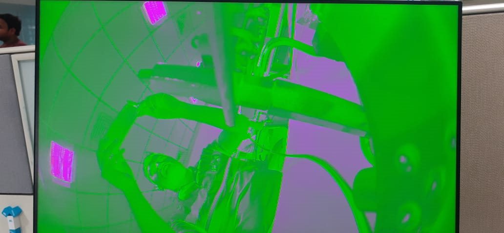

Dear Sir,
I have installed latest SDK (08_05_00) on ubuntu 18.04
i have added image sensor code for sony ISX016 and build the imaging folder it got built successfully
serializer : TI DS90UB913A
WIDTH : 1280
Height :724
when i execute the single camera application i get the error below

123.253903 s: ISS: ERROR: Initializing sensor [ISX016-UB913] failed !!!
123.253955 s: ISS: Initializing sensor [ISX016-UB913] ... Done !!!
Error initializing sensor ISX016-UB913
Creating graph
Initializing params for capture node
capture_config = 0x0xffff9491ae08
Creating capture node
obj->capture_node = 0x0xffff9488cb88
Display Set Target done
vxSetGraphScheduleConfig done
123.270436 s: VX_ZONE_ERROR:[ownContextSendCmd:802] Command ack message returned failure cmd_status: -1
123.270450 s: VX_ZONE_ERROR:[ownContextSendCmd:838] tivxEventWait() failed.
123.270456 s: VX_ZONE_ERROR:[ownNodeKernelInit:525] Target kernel, TIVX_CMD_NODE_CREATE failed for node node_96
123.270463 s: VX_ZONE_ERROR:[ownNodeKernelInit:526] Please be sure the target callbacks have been registered for this core
123.270469 s: VX_ZONE_ERROR:[ownNodeKernelInit:527] If the target callbacks have been registered, please ensure no errors are occurring within the create callback of this kernel
123.270631 s: VX_ZONE_ERROR:[ownGraphNodeKernelInit:583] kernel init for node 0, kernel com.ti.capture ... failed !!!
123.270641 s: VX_ZONE_ERROR:[vxVerifyGraph:2055] Node kernel init failed
123.270647 s: VX_ZONE_ERROR:[vxVerifyGraph:2109] Graph verify failed

  • Hi Madhav,
    Couple of questions,
    - What's the lane speed that you are trying to set in the CSIRX?
    - Is it the new camera that you are trying to bringup?
    - Was this working fine in earlier release?
    Brijesh
  • Dear Sir,
    yes , sensor name is Sony ISX016
    yes it is working fine for SDK 7 version , now we trying to migrate changes to new SDK.
    As per the old SDK please find out the params initialised
    static IssSensor_CreateParams isx016CreatePrms = {
    SENSOR_SONY_ISX016, /*sensor name*/
    0x6, /*i2cInstId*/
    {SENSOR_0_I2C_ALIAS, SENSOR_1_I2C_ALIAS, SENSOR_2_I2C_ALIAS, SENSOR_3_I2C_ALIAS}, /*i2cAddrSensor*/
    {SER_0_I2C_ALIAS, SER_1_I2C_ALIAS, SER_2_I2C_ALIAS, SER_3_I2C_ALIAS}, /*i2cAddrSer*/
    /*IssSensor_Info*/
    ISX016_OUT_WIDTH, /*width*/
    ISX016_OUT_HEIGHT-ISX016_META_HEIGHT_AFTER, /*height*/
    1, /*num_exposures*/
    vx_false_e, /*line_interleaved*/
    {TIVX_RAW_IMAGE_16_BIT, 7}, /*dataFormat and MSB [0]*/
    0, /*meta_height_before*/
    ISX016_META_HEIGHT_AFTER, /*meta_height_after*/
    ISS_SENSOR_ISX016_FEATURES, /*features*/
    ALGORITHMS_ISS_AEWB_MODE_NONE, /*aewbMode*/
    30, /*fps*/
    4, /*numDataLanes*/
    {1, 2, 3, 4}, /*dataLanesMap*/
    {0, 0, 0, 0}, /*dataLanesPolarity*/
    800, /*CSI Clock*/
    4, /*numChan*/
    160, /*dccId-390*/

    i can able to get display of single camera output. but i got the green display
    is there any solution for this or need to write our own kernel to convert.
    Thank,
    Madhav
  • Hi Madhav,
    This looks to be issue with interleaving format of YUV422 data, like application is expecting UYVY and output is in YUYV format..
    Are you using LDC in the application for the format conversion from YUV422 to YUV420? This is because LDC supports only UYVY format.
    Also if you are bypassing LDC and directly connecting capture output to display, then display supports both the formats.. We might just have to set correct format in the display..
    Brijesh
  • Dear Sir,
    we are bypassing LDC and ony capture and display node availabe.
    Madhav
  • In this case, it is coming due to format mismatch. Like capture is outputting in UYVY format, but display is configured for YUYV format. Please try changing format in the display node.

    Madhav
  • Madhav,
    I am not sure which data format you are using in the capture output, but can you try swapping value of format->dataFormat in below two cases in vx_display_target.c file?
    case (vx_df_image)VX_DF_IMAGE_UYVY:
    format->dataFormat = FVID2_DF_YUV422I_UYVY;
    format->pitch[FVID2_YUV_INT_ADDR_IDX] = (uint32_t)obj_desc_img->imagepatch_addr[0].stride_y;
    dispPrms->bpp = 2;
    break;
    case (vx_df_image)VX_DF_IMAGE_YUYV:
    format->dataFormat = FVID2_DF_YUV422I_YUYV;
    dispPrms->bpp = 2;
    break;
    Brijesh
  • Dear Sir,
    capture is setting the data format to VX_DF_IMAGE_UYVY  as you can see in the below functions it is going into first switch case
    this function is present in vx_capture_target.c
    static uint32_t tivxCaptureExtractDataFormat(uint32_t format)
    uint32_t dataFormat = FVID2_DF_BGRX32_8888;
    switch (format)
    printf(" capture ::VX_DF_IMAGE_UYVY\n ");
    break;
    printf("capture ::VX_DF_IMAGE_YUYV\n ");
    break;
    default:
    break;
    return dataFormat;
    as you told me to swap the format->dataFormat i have done that  i am getting image like this (hand colour getting blue)
    Madhav
  • Hi Madhav,
    For VX_DF_IMAGE_UYVY input image format, can you try below options for dataFormat and see if any of them giving correct output?
     FVID2_DF_YUV422I_VYUY
     FVID2_DF_YUV422I_YVYU
    Brijesh
  • Dear Sir,
    I have tried all options as mentioned above, didn't get correct output.
    Madhav
  • hi,
    Are you sure then that your sensor is outputting yuv422 data? Can you save one image from the sensor and analyze it offline?
    Brijesh
  • Dear Sir,
    i have attached yuv dumped output
    width 1280
    height 724
    color space  yuv
    data container interleaved 4:2:2
    channel order yuv
    bit depth 8bit
    cap_0004.zip
    Madhav
  • Hi Madhav,
    This looks like proper UYVY frame. I could see correct colors with UYVY format. What TIOVX format that you are using for this frame?
    Brijesh
  • Dear Sir,
    i have used format->dataFormat =  FVID2_DF_YUV422I_YVYU; in vx_display_taget.c file
    and  in vx_capture_target.c dataFormat = FVID2_DF_YUV422I_UYVY;
    Madhav
  • Hi Madhav,
    Can you please change fvid2 format in display to FVID2_DF_YUV422I_UYVY?
    Brijesh
  • Dear Sir,
    After doing the above changes getting the image green color as i have attched here .
    Madhav
  • Strange, Is there any other changes in the DSS node? Are you using zero copy mode in the DSS Node? Which SDK release are you using?
    Brijesh
  • Dear Sir,
    we are using  SDK (08_05_00) on ubuntu 18.04.
    i haven't done any changes in DSS node.
    can you please explain what is  zero copy mode in the DSS Node?
    Madhav
  • Please make sure to set opMode to TIVX_KERNEL_DISPLAY_ZERO_BUFFER_COPY_MODE in Display create Parameters..
    Brijesh
  • Dear Sir,
    As i have shared already app_single_cam_main.c to you .
    by default it is  set to TIVX_KERNEL_DISPLAY_ZERO_BUFFER_COPY_MODE only.
    Madhav
    Are you sure that capture output is directed connected to display? Because in that case, you should got correct output for atleast one of the format.
    I think we would have to now check all possible combinations..
    There are 4 formats possible in CSIRX (YUYV, YVYU, UYVY, VYUY) and 2 in display (YUYV & UYVY), can you try these total 8 combinations and see if any one of them is giving correct output?
    Brijesh
  • Dear Sir,
    yes beacuse as per below loop VISS and AEWB nodes gets bypassed and i am selection LDC as zero
    if(sensorParams.sensorInfo.raw_params.format[0].pixel_container == VX_DF_IMAGE_UYVY)
    yuv_cam_input = vx_true_e;
    printf("YUV Input selected. VISS and AEWB nodes will be bypassed. \n");
    i have tried all combinations as mentioned CSIRX (YUYV, YVYU, UYVY, VYUY) and 2 in display (YUYV & UYVY) still not getting the correct output.
    please let me know anything form my side need to provide for your references
    madhav
  • Madhav,
    Unfortunately, no. If your sensor is outputting one of the above format, the one combination should have worked.. So i suspect, either the output format is incorrect or there is some other module between capture and display..
    Brijesh
